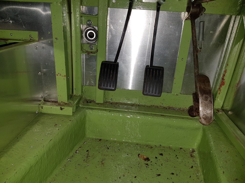

Today was spent fitting the MG Midget pedal box. The throttle pedal is from a Spitfire and will need tweaking.

looking good ...whats the issue with the throttle ? travel ?
  #585
Old 27th December 2016, 19:52
It's just the position relative to the brake pedal.

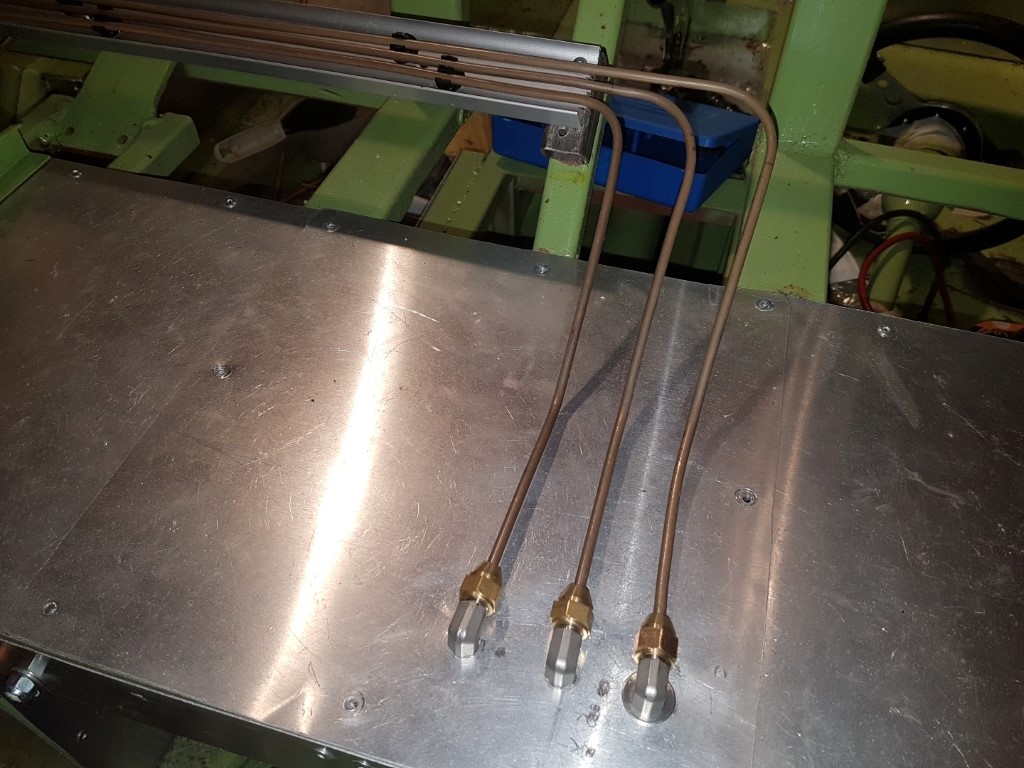

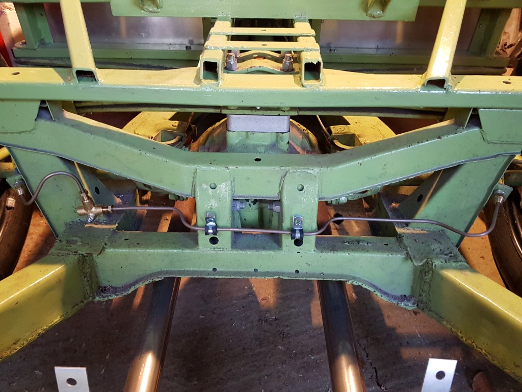

Laying brake lines at the moment -
The clips need attaching.

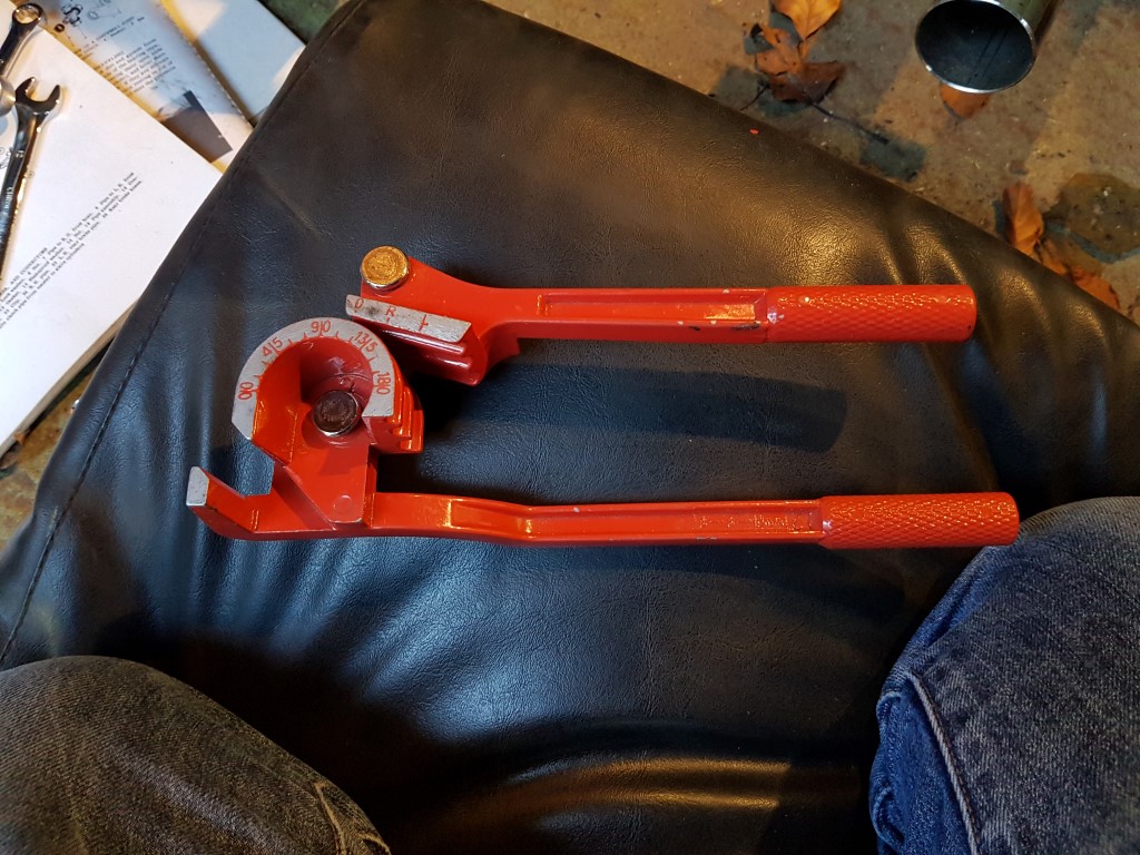

Always fun to use a new tool making neat bends -

Oxford - Brake lines look good so far.

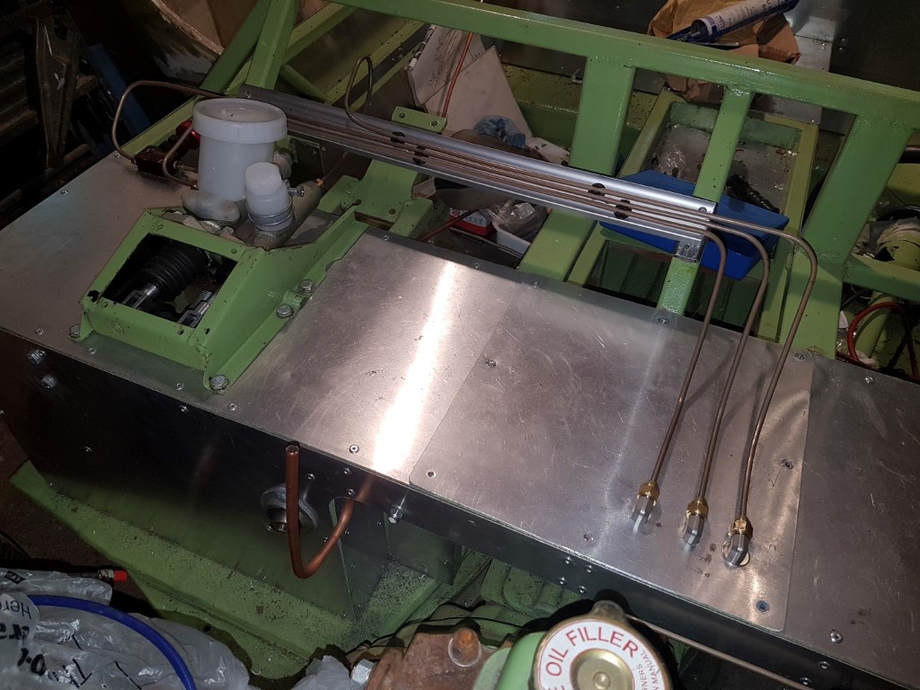

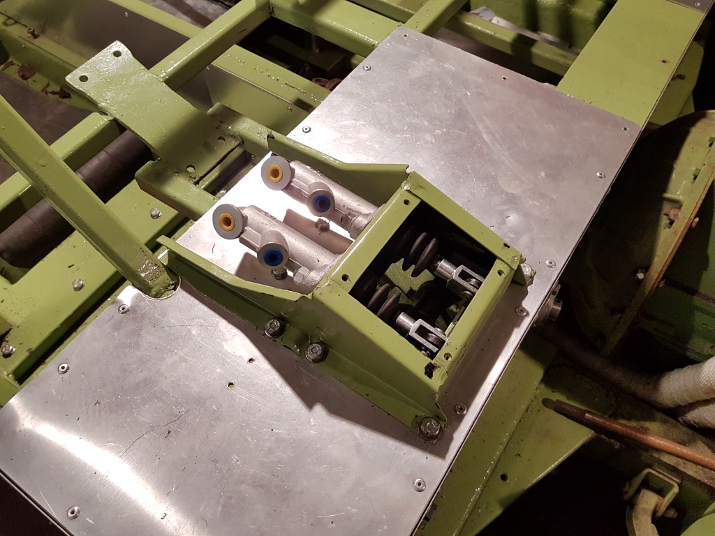

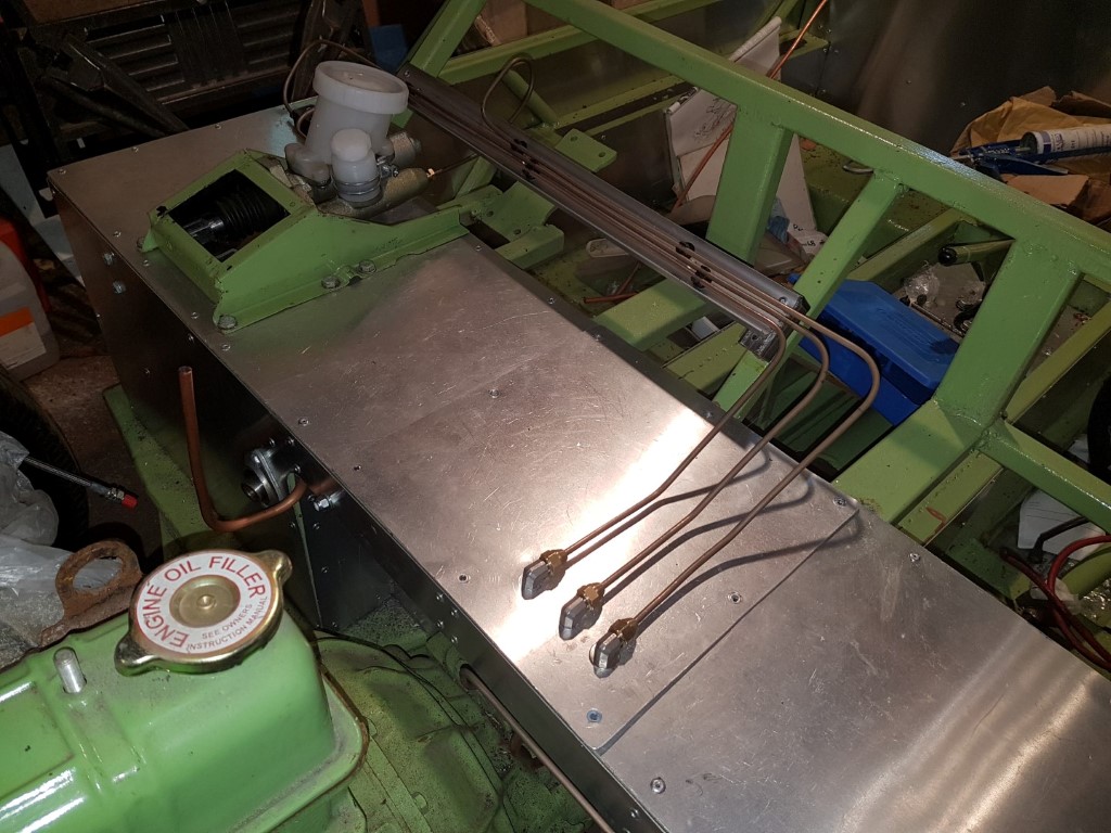

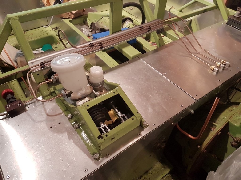

So, my plan is to have a completely functioning moon-buggy on which a strengthened body can sit.......and be removed quickly and easily to make working on the car a pleasure. This means that nothing - speedo drive, throttle cables, brake pipes etc. - can pass through the body..........
I give you my hydraulics......so far.......
I'm using a dual circuit Midget pedal box and master cylinders. Bending and routing the pipes has been rather fun and therapeutic.
  #591
Old 5th May 2017, 17:44
molleur molleur is offline
Posts: 1,401
Good job bending those brake pipes, very neat!

Old 5th May 2017, 18:00
SECONDED ..NICELY DONE ...Takes f'ing ages getting it nice and even doesn't it ? !!
I think Phil J has the same approach to his builds ...running driving buggy clad with a bodyshell ...

Details like nicely routed copper pipes that are dead straight with even bends can really make the finishing top notch in an engine bay, something I like to see but have never been able to achieve, how the heck do you get dead straight runs? Bends are not so bad, it's the straight runs

Brake pipe straightener..............for the anal builder!

Nice one. Have seen them before but were around the £200 mark, £40 odd seems much more reasonable, might have to invest in one of those.
