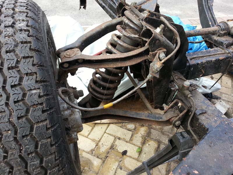

This is the sorry donor, bought from ebay for £205 as a part finished restoration!
The nice thing about it (if there is one..) is that the chassis underwent a rebuild so everything was new - but that was about 6 years ago, and it was stood since then...
It will need a full strip and rebuild again, but has some nice touches like stainless steel brake hoses and a really good chassis that won't need any welding!!

err, the whole chassis - new everything - but then they parked it up under a tarpaulin for 6 years or so! The rear brake drums and front calipers still had the paper protection and labels on them!
Pity, as it will need a complete stripdown again but at least all the bolts should come off fine! Will repalce the rubber bushes with silicone ones as well while I am at it.
