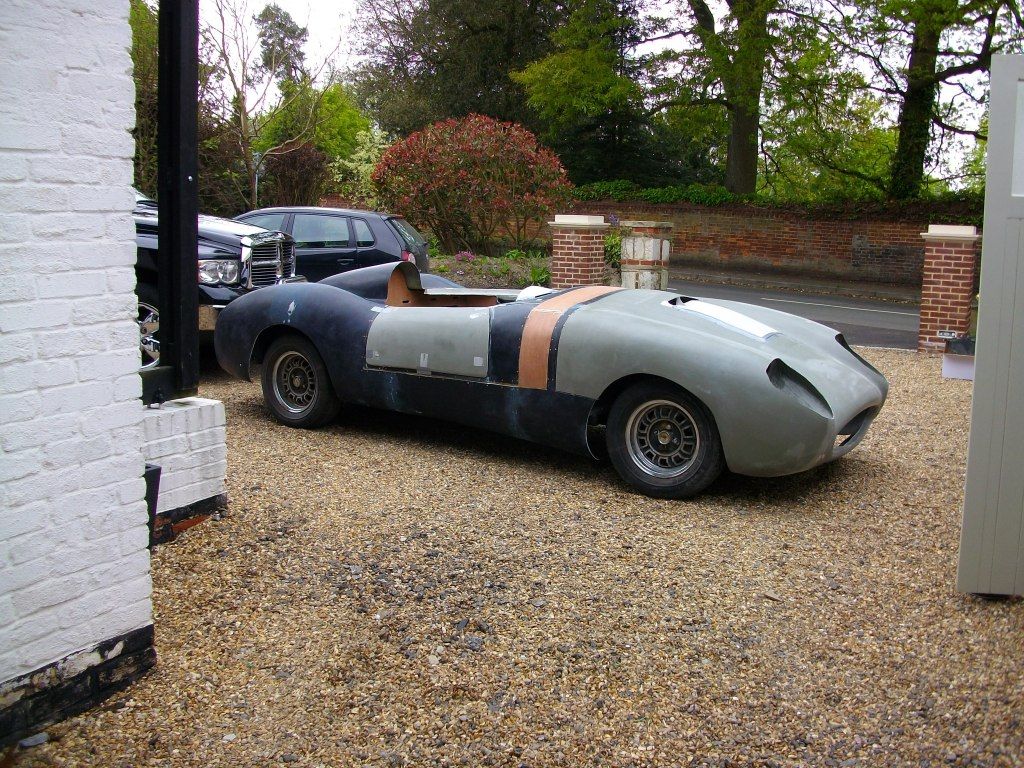

right then got it cracked, harder than building the car, this is a shot of the front quarter from the drivers side.
All the structural alteration made ply wood lots of glue screws and filler foam, I have two rea bulk heads one to stop the spare wheel coming forward and one that forms storage two lits for ever day stuff and also allows for the seat belt mounting to run thru.
[IMG] [/IMG]

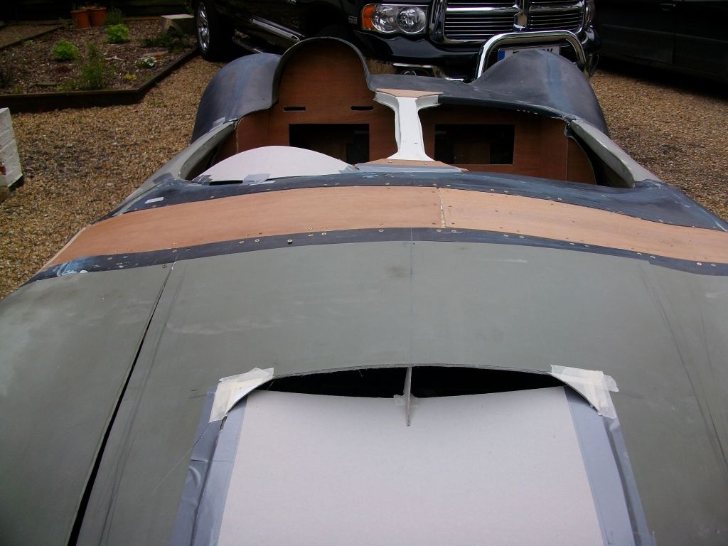

All the footwell ply and rear quarter ply panels are cut to fit and glue into place I now need to be glass them all into the body and two each other. This is my version of the Norfolk scoop or can I call it the Surrey Scoop or the inverted scoop, decided to cut it into the bonnet to that I get the line of the wing swooping over the doors with out the height of the bonnet centre let alone adding height in a scoop. I just hope I can glass this in to achieve the cardboard mock ups.

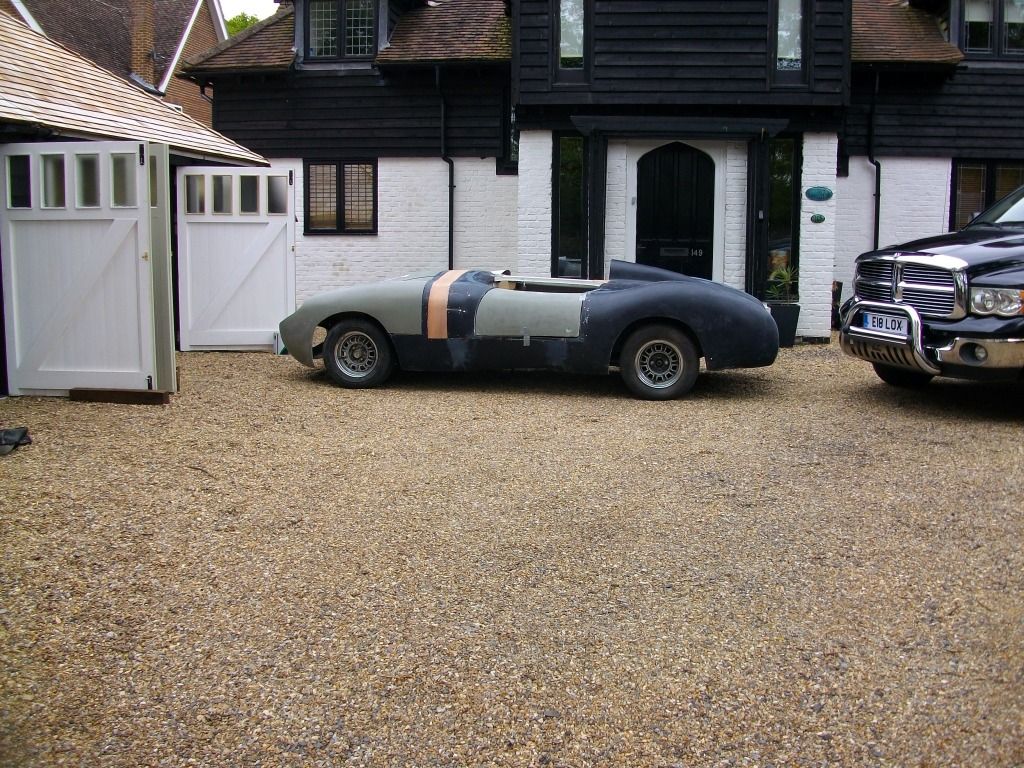

I wanted to step back and get a distance shoot of the passenger side probably a little far back

Showing how subtle the scoop is within the bonnet

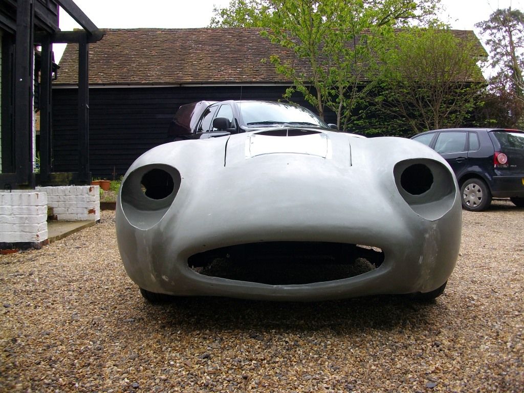

from the front closer detail, thinking about making the instrument binnacle a little larger

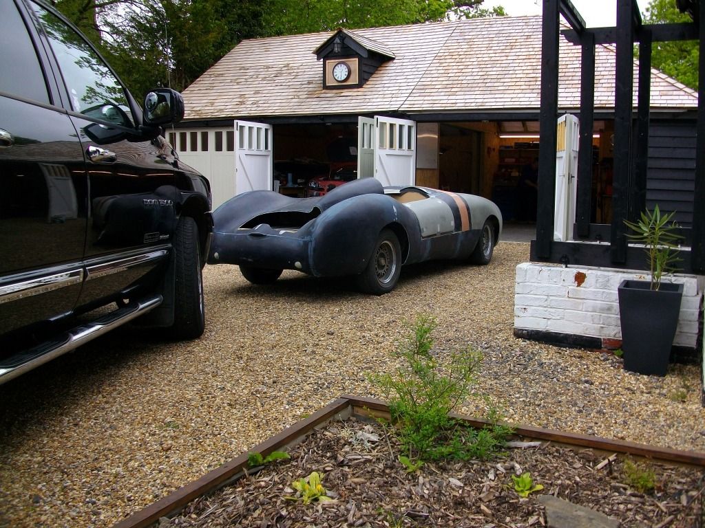

From the rear quarter.
The great thing about the scimitar based G46 and I do not know if this is possible with the spyder is that as everything is bonded to the floor pan/bulkhead which allows me to simply hoist the body off once it is structural bonded and put it onto a table which will allow me to finished the engine, gear box drive chain etc etc and also start filling and preparing the body separately

The inverted scoop is a very neat solution to the raised area of the bonnet that was giving me some doubts when reviewing the photos of Orca I took at Exeter and Poole...

I wanted to be careful here and respect Gary's design with the central humping bonnet which is part of the Sammio ranges DNA. With the inverted scoop the hump line to the bulk head is respected, however I was not unhappy with the original bonnet line, it's just that I wanted he air scoop.
