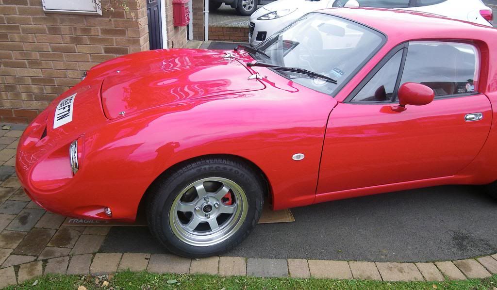

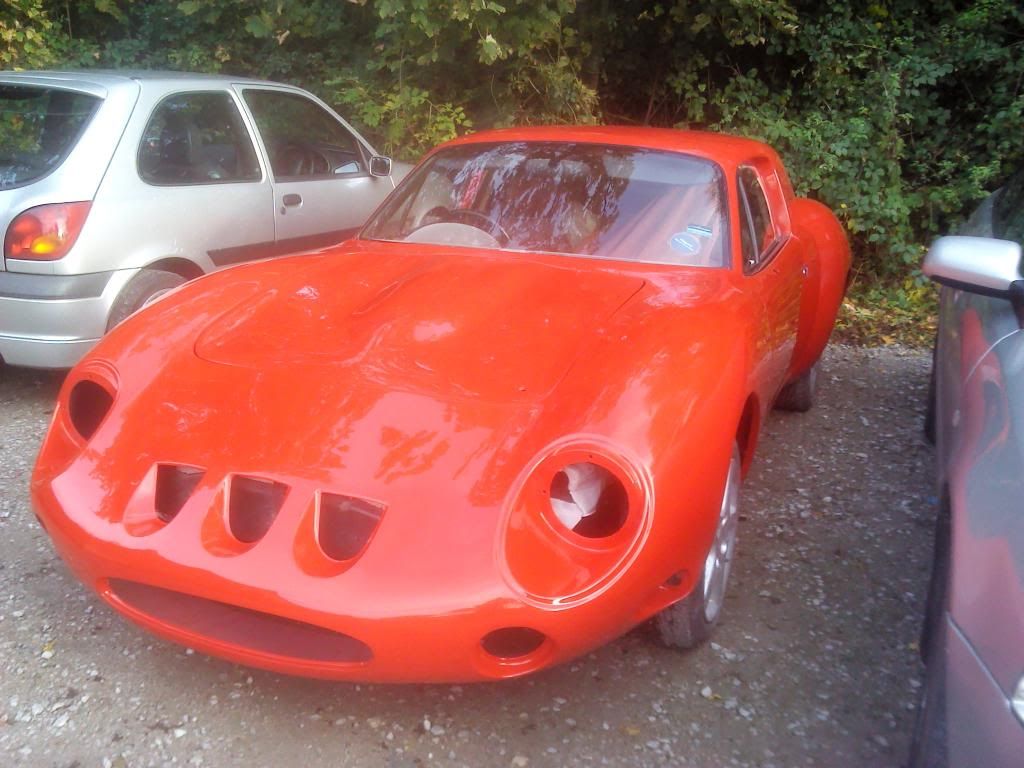

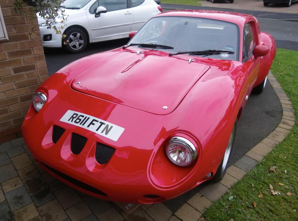

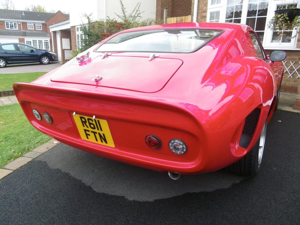

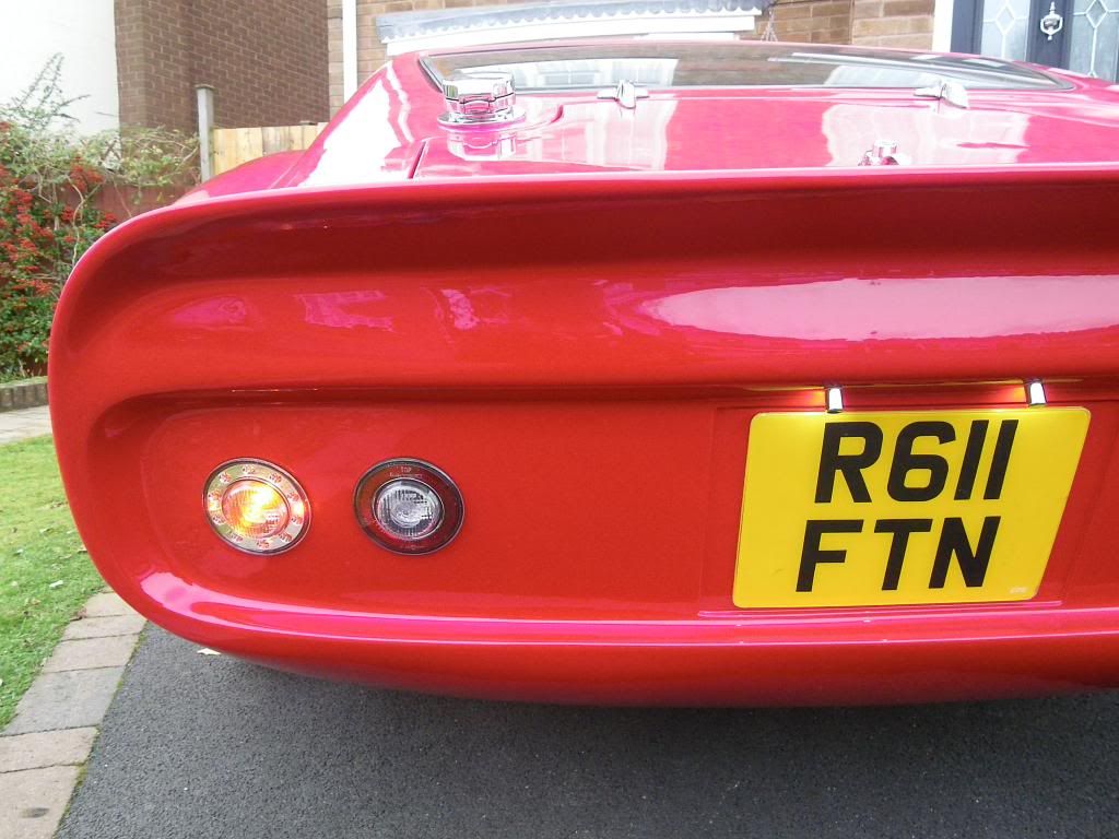

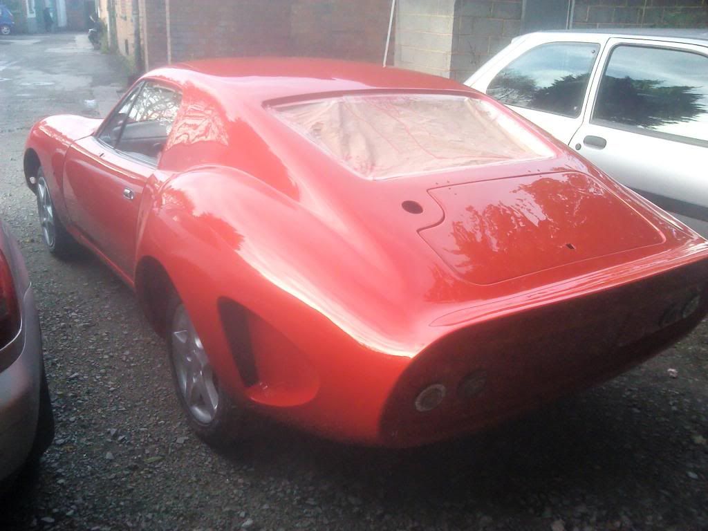

Hi, My car is starting to take shape, so I thought I would post up some pics.
[IMG] [/IMG]
[IMG] [/IMG]
[IMG] [/IMG]
[IMG] [/IMG]
[IMG] [/IMG]
[IMG] [/IMG]
[IMG] [/IMG]
[IMG] [/IMG]
29th November 2013, 17:49
Posts: 549
Nice start to your build!
29th November 2013, 18:02
Posts: 3,558
Not bad for a first posting but when are you going to make a 'proper' start?
You didn't even fail to post pictures three times before asking!
We do have standards on this forum.
Joking aside, that looks real nice
29th November 2013, 19:38
Join Date: Nov 2013
Posts: 13

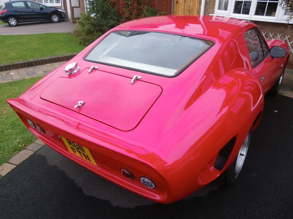

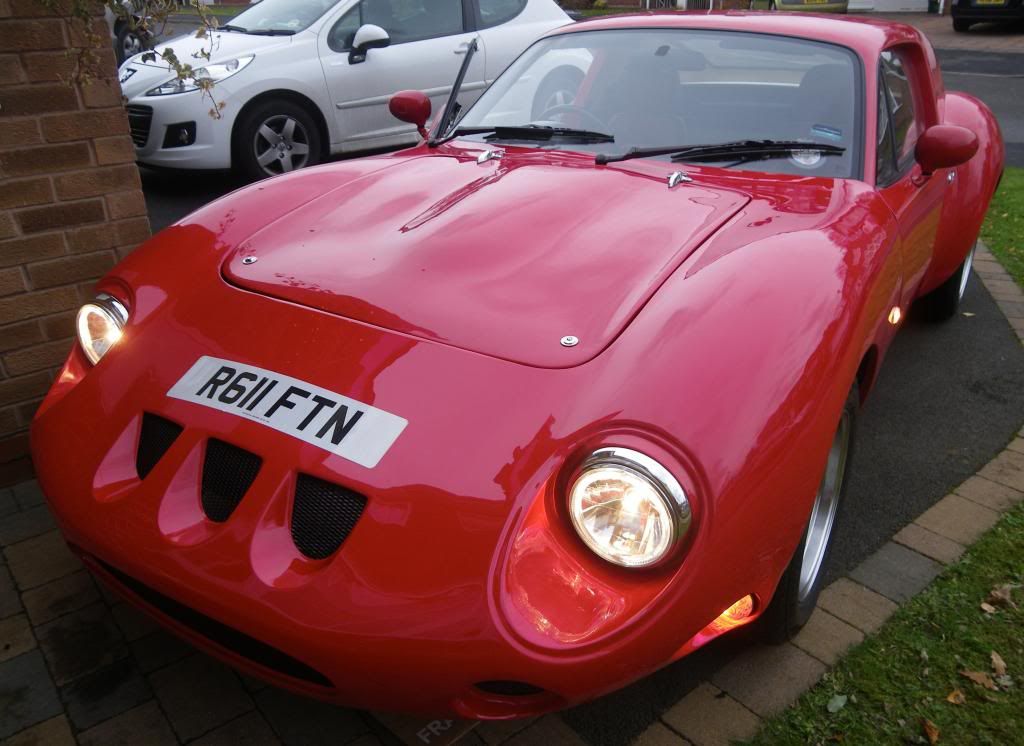

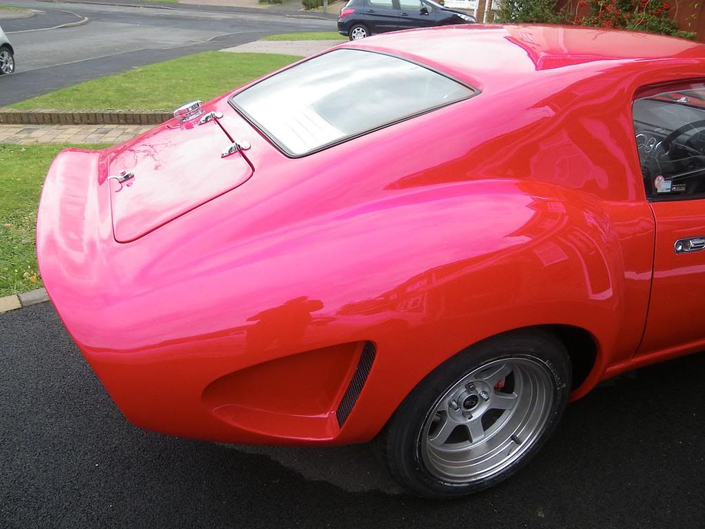

Thanks, I have read pretty much read every thread on here, and the info has helped a lot with my car. It has taken me about 7 months to get to this stage, and Its great to be finally able to drive the car. Still a lot to do though before I can say its finished, I have the rubber seals around the door windows, finish bonnet seal, door cards, might get some chrome ring surrounds cut for the rear lights, and paint still needs some attention with the odd run on the sills, and all the rest of the trim. Overall im happy with how its turned out, and here's a few more pics of the car after it had been sprayed.

Hello Mark.
Forgive my memory, or lack of. but which Mark are you?

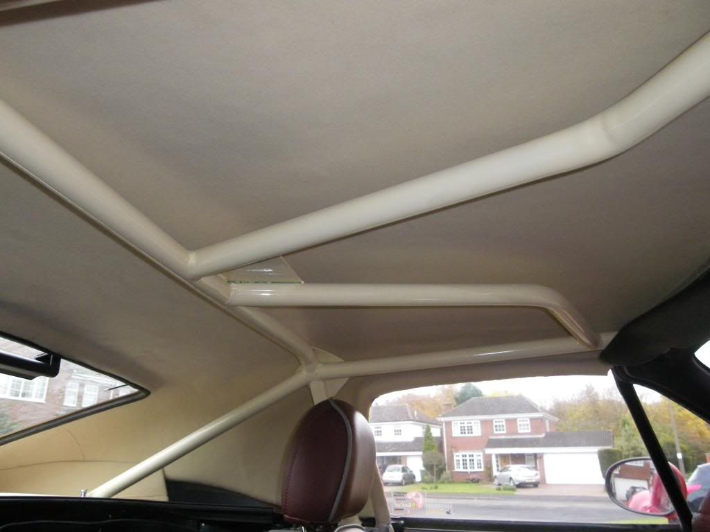

Your car looks great BTW and I love what you have done with the cage and headliner.

Thanks for jogging my memory Mark. You have gotten on really well, and you are driving it too, brilliant
Please give me some info on the wheels, can't see a spacer on the rear.
2nd December 2013, 16:16
Join Date: Nov 2013
Posts: 13
Thanks Chris. The wheels are Rota Grid-V, 15" 9j ET0 on rear, and 7j ET20 on the front, with no spacers. I think with the offset, the wheels come out far enough, and I don't think I need to fit spacers.

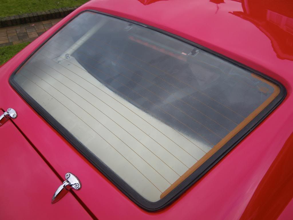

Has anybody connected the heated element of the mx250 rear screen and got it to work?
[IMG] [/IMG]

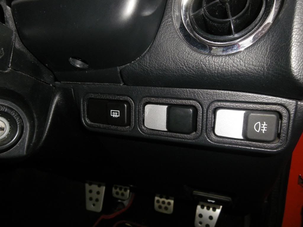

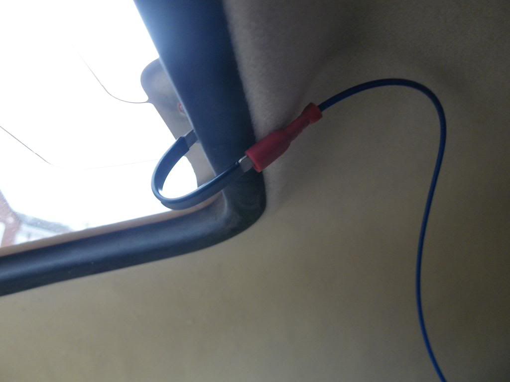

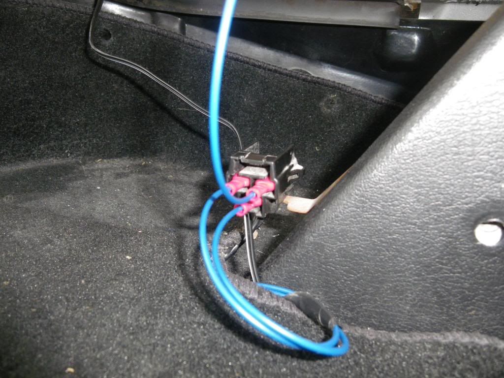

This is what I've done so far. I had to buy the switch, relay, and fuse block as my car wasn't fitted with them. The connector for the switch I found loose behind the headlight adjuster switch which I have now changed for the defog one.
[IMG] [/IMG]
The relay plugs into a connector behind the carpet near where the lock was originally in the boot. the fuse block connects near the battery. Their is also a slot in the main fuse block under the drivers foot well, slot 20 for the defog. I haven't bought the wiring loom that goes from the connection behind the passenger seatbelt, to the screen, as it costs 70 quid, which for a cable is stupid, and also not even ideal as the connectors on the Renault screen are a lot wider apart than on the mx5. So instead have tried to wire it myself. Their are 3 wires on the connector behind the seatbelt, red, black, and yellow. I have connected the red and yellow wires together and connected it to the left side, and the black to the right.
[IMG] [/IMG]
I don't think its working yet but hard to tell as the screen wasn't even misted up, but I expect it should have at least warmed up the surface slightly, but it just stayed cold. When turned on though, the light at least is coming on the dash.
Does anyone know if it matters which way around the connections are on the screen, and I have just realised the screen is upside down compared to when on the Renault 5, so maybe it needs the black left, red & yellow on right.

Put a test lamp or multimeter between the two wires you have connected to the screen and make sure you have power. If not check the live feed through the multimeter or test lamp with the other end to a known good body earth. If you now have a light or reading then the earth to the screen is no good. If you still have no power feed however then check the output from the relay.

Thanks for the advice. I've just tried connecting a bulb across the live & neg, and got nothing. Also the light on the dash doesn't come on, until I connect the other earth(yellow) cable to the neg, but still no light. I think this is telling me that the earth is good, but their is another issue in the circuit. I feel this is going to need a fair bit of testing to find out what's wrong. I think my prime suspect might be the used relay I bought, but really I haven't got a clue yet.

Dan usually does our wiring, and I'm no expert on electrics, but it won't make any odds which way around you put the wires to the rear window. Is it worth running a new circuit?

I expect the circuit should all be in place, well I hope so, but I suppose I could run a new circuit if I cant get it to work. But my first plan maybe tomorrow is to see if the relay is dodgy. I found out after a bit of searching, their are two identical relays one in the main fuse box for the fan, and one on the side near fuse box for the horn. So I think I will swap it with the horn relay to see if its faulty or not.

hi ,cars looking really good what material did you use for the headlining ?
8th February 2015, 18:17
Join Date: Nov 2013
Posts: 13
Thanks, well the interior was looking good then, but now not so much now. The exact headlining I bought was Cream Brushed Nylon Foam Backed Headlining 3m x 1.37m from AS-Trim.co.uk. I used a spray adhesive, which is now not so great, as its now started to sag. Also unless you get a great seal on the windows, and drive the car regular, go for vinyl, as the lining will get damp. That's mostly down to me though, as my one window has a great seal, I just need to sort out the other side.
Honestly though I don't know what the best adhesive to use on the headlining would be, but if like me you sprayed primer on the inside, you need to roughen up the surface for the adhesive to get a good grip.
When I get chance I will probably be changing mine to vinyl, although not so easy now its on the car. may have to cut the roof off and start again
