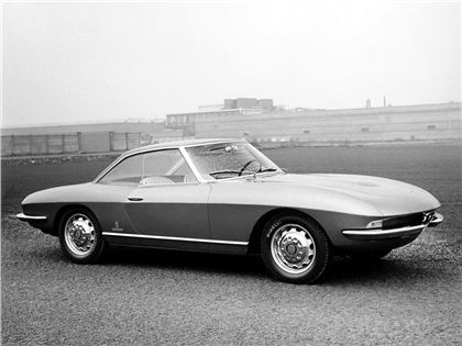

Hehehe. Sorry meant 2600 speciale. If you find the right pics its in a light metallic green. Don't know why I thought 2200. Might be under concept 2600 Alfa .one also in 1963 keeps coming up. When I did some research before. The back end on that reminded me of the duette convertible sleek lines down the boot.

The boot lid is almost as long as the bonnet.
1st February 2017, 19:50
Ooooh, that's better -
1st February 2017, 19:58
Posts: 725
See not a bad looking machine. I knew from the start the boot wouldn't match up so I went down the prototype route and found the masterpiece above in my research. And how to use what was available from the Alfa parts list. Big boot not such a bad thing when it finishes the lines off so well.

Thing with prototypes is that only one is usually made so their quite rare. And style cues are used into mainstream. Bit like getting feedback from the public and seeing how the design language is received by potential customers for the future. Bit like the Montreal

The Alfa 2600 concept has a touch of the Razor Edge Karmann Ghia about it, which also has a big rear end -
