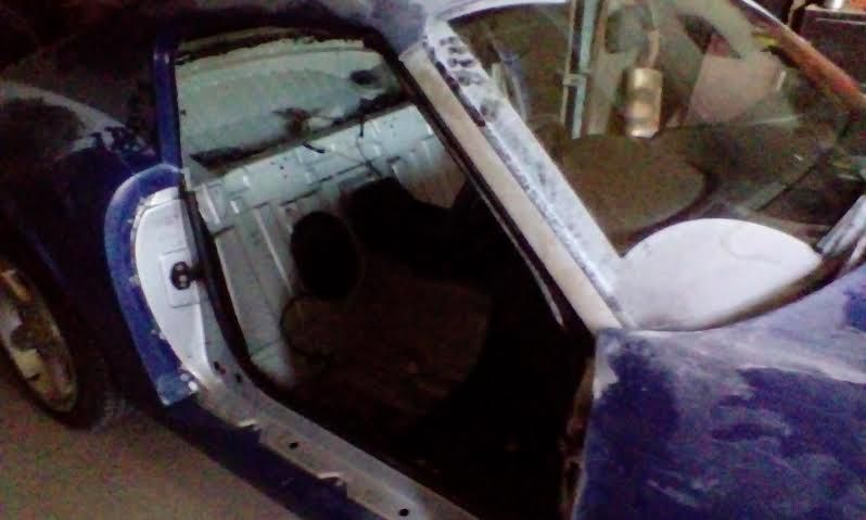

I have also removed the doors and interior in preperation for the shorter door / higher cill modification that this ones getting too ...

I do like the look of the modified door and sill but it looks like an awful lot of work. Could anybody do a photoshop of the rear of the door being curved and the rear wing / sill gap being filled but leaving the bottom of the door and sill itself alone?

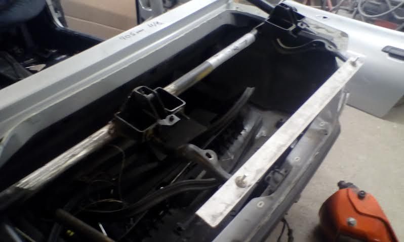

rest of the afternoon was spent mostly removing stuff ...rear bumper and all its bracketry in preperation for a Jeff H rear framework to be fitted.
seat belt mounts were cut off as this ones getting a harness bar ..I welded 4 ringbolt seat belt mounts into the car as well ...2 on inner cill where a handy grommet lives and two on the rear of the tunnel...
