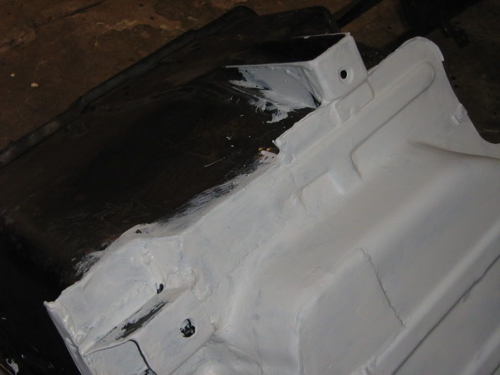

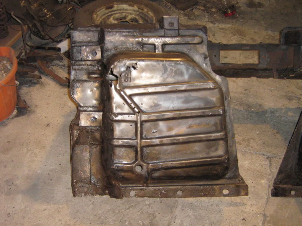

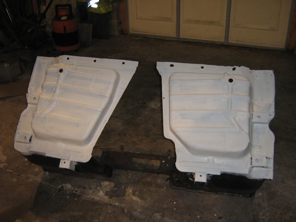

Floor pans are all repaired and a bit of seam welding to give me another half inch on the tyre clearance, rust treated and primed.
before
Also got the petrol tank bolted in and connected, bolted the rear frame and corners....not a bad fit at all

Floorboards cut ,sealed and primed

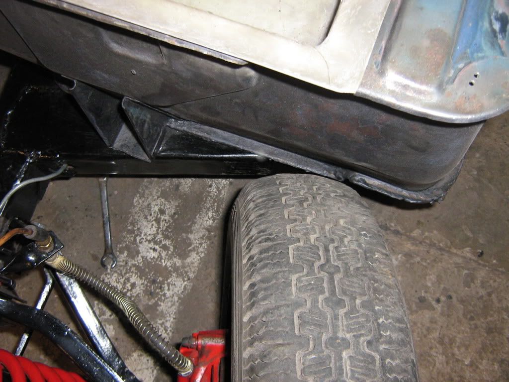

Well as others have said, you can only look long enough before the big decision to bond and having thought I had got it just about there....the day of bonding cometh!
Straps ready and ratcheted? and paste and glass in hand and this is where I got
Was generally quite happy with my work.....Until realization took hold....that little alignment that I thought would be just a trim back on the cill line
All looks fine
Other side
Not only serious bulkhead bashing to do (yes it is sitting square) but there is no way the wheel is going to run past that shutline.....Unless someone would like to tel me otherwise I am in for cutting the panel and shunting it all back?
Then I looked at the top
not sure if you can see it but the far end kicks right forward! so I have definately got an alignment problem.

What about cutting through your glass and bonding down the left hand side and pulling the body back into position, now the right hand side is fixed you may get enough flex to align it all?
Would be better id have thought than cutting a section out from the front.

Ooh, bad luck. Did both sides line up on your trial fits? Is the rear face of the cockpit straight across the top of the frame or has it slipped forward on the nearside? I hope you find a simple fix for this one.
11th June 2012, 07:25
NICK , CLEARLY SOMETHING IS WRONG ....Its very difficult to say what the issue is without seeing the car ....our bodies do run out a bit on the pass. side , but it doesn't normally create an issue like that ...all the bodies are from the same moulds , so they cannot change , all the cars are slightly out one side , but yours is puzzling ....
Sometimes an unfitted body can parallelogram a bit whilst sat around , depending on how it is stored.....we fit one side , clamp it and then tug the other into place when we do ours ...
I think you may have to do a bit of corrective surgery like tlrtone did on his body , but you may want to check your bonnet alignment first ...

It all looked sort of right everywhere, although the difference between the suspension and wheel to the bulkhead is concerning, as driver side plenty of clearance, passenger side tyre is rubbing the bulkhead? The bulkhead is square to the chassis and if I had moved it back to clear the tyre, it would have made my current situation worse!
I trial fitted the bonnet for alignment and I rekon passenger side needs to come back a good 2".
I know I am not sitting square with the frame rail at the hump....hump is tight against the frame and runs out about 1" so need more than that. Can`t go any further back driver side as I am already sitting tight against the frame rail?
Looking at the rear arches, if I pulled the body any further forward the wheels would touch the rear of the arches
From the rear, all looks like it is sitting square and I am happy with the body sitting where it is.
Am thinking this car will be good at going round left hand corners!
Think I will need to sit and ponder a while before I start any cutting as with the amount of bonding paste I used I dont relish cutting through it!!!

It may be the angle the picture's been taken at, but to me it looks like your nearside rear wheel is too far back in the arch. That would explain the front of the body being too close to the nearside wheel. How set is your bonding paste? I'm aware that it can take a few days to go off fully, depending on how much catalyst you add (if any in my case!) and it might be worth seeing if you can separate the body from the chassis now and have another go if it isn't aligned properly. Good luck.

Nick, it sounds exactly like mine, so I would say that you may not have anything wrong with your body or your chassis.
The side rails on mine needed widening at the rear to sit under the body (and have space to put the ply side panels under the lip), and the rear frame was not square with the back of the cockpit on the body.
The first bit was rectified by cutting and re-welding the side rails. I did mine with the body off though which did make life easier. You could try and do it with the body on, or even cut the rail and then make up a bracket that can be bolted in - it is purely a strengthening rail so bolting it would be fine.
the rear frame was a minor issue in my mind as I just cut and trimmed the plywood panel at the rear to fit and then made adjustments with the final filler and bonding paste, so no major trauma.
The front wheel arch looks exactly as mine did and I too pondered a while over a few evenings. The outcome was my cut and shut story, that is on my thread, and actually I think it turned out better for it! You can get the bonnet to line up and fit, so don't panic over that. I am still not sure why the body fitted like it did, I took many measurements and diagonals and in the end decided that I would fit MY body to MY frame and MY chassis and this meant minor adjustments to all of them! The overall results is very good and even though things are not 100% square or a mirror image from side to side, it doesn't really matter in the overall scheme of things, people WILL NOT notice!
So don't pull you hair out trying to decide where the error is, just satisfy yourself that you have no major chassis twisting by taking diagonal measurements and the bulkhead is fitted correctly ( you can't really get this wrong if the bolt holes line up!) and then just make a plan to adjust the body to fit.
Take a deep beath and get your marker pens out and plan your cuts. Remember that it is only fibreglass and the worst that can happen is that you make a wrong cut and have to add more fibreglass or cut it and do it again!
