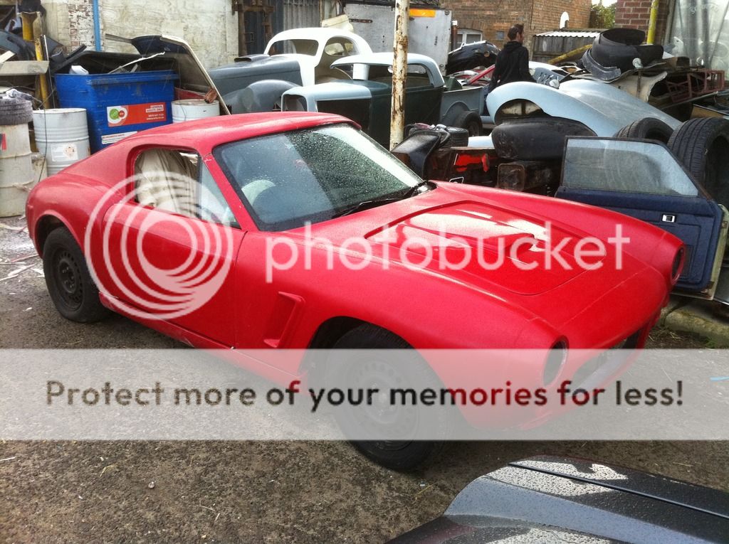

14th January 2016, 08:07
Posts: 607
14th January 2016, 08:11
Join Date: Nov 2014
Location: Norwich, Norfolk
Posts: 412
It looks great Geoff, you'll enjoy your ride home as you'll be in the coolest car on the road.
I look forward to seeing progress with your interior as you may have ideas I can 'borrow'.
14th January 2016, 08:12
Join Date: Feb 2015
Posts: 678
Wow. Seriously, by anyone's standards that is a stunning drop of paint. Fantastic work.
#reallyexcitednow
14th January 2016, 08:16
Posts: 607
Originally Posted by y cymro
Looks damn good in red.
We are going to build a red one for a customer. He has a healthy budget so should be a real nice one! Can't start it till March though as we have three to cars to build before then.
14th January 2016, 13:43
Location: Swansea
Posts: 803
Youve done a nice job Richard, Geoff will be absolutely chuffed with that.
14th January 2016, 15:37
Posts: 607
Thanks for the great comments.
Unfortunately Geoff broke down on the way home. I mentioned to him that his water pump was noisy, which he knew about but didn't quite make it.
