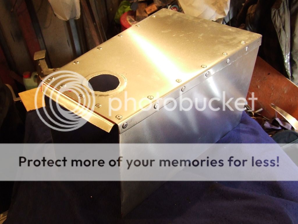

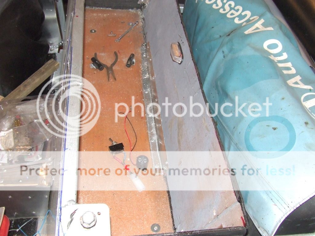

The boot box in front of the fuel tank is now done but I chickened out of cutting the boot support outriggers? but I have a devious plan where I cut them off and re weld them on at a new angle to support the boot and keep the DVLA happy.

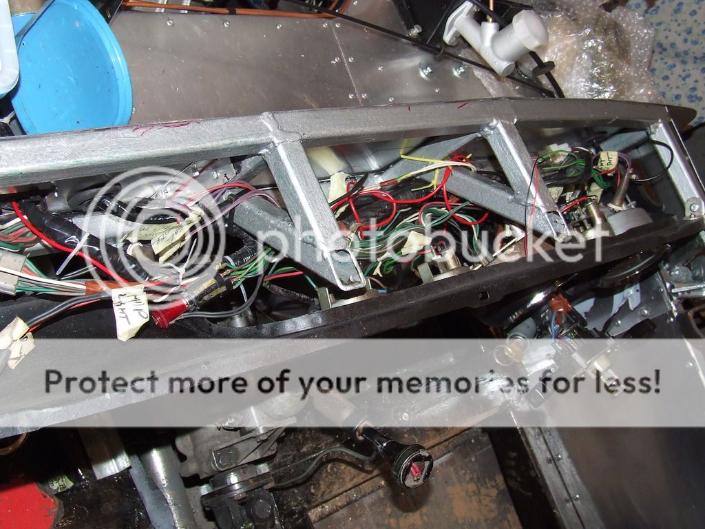

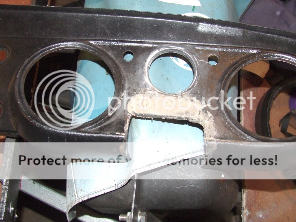

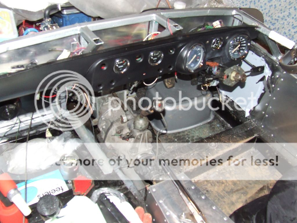

I would like to get the car running before the body goes on So I stared on the electrics I had to re-modify the modified dash. And fitted in place with a grate deal of very accurate guesswork
[IMG ][/IMG]
[IMG] [/IMG]
This makes the wiring behind the dash much easier to install as you can see.
[IMG] [/IMG]

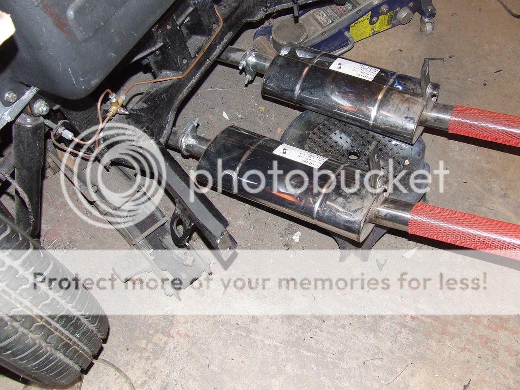

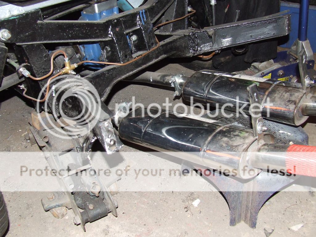

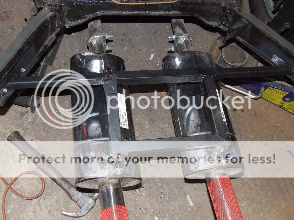

I also remade the exhaust rear support hopefully the body should clear it ok!
[IMG ][/IMG]

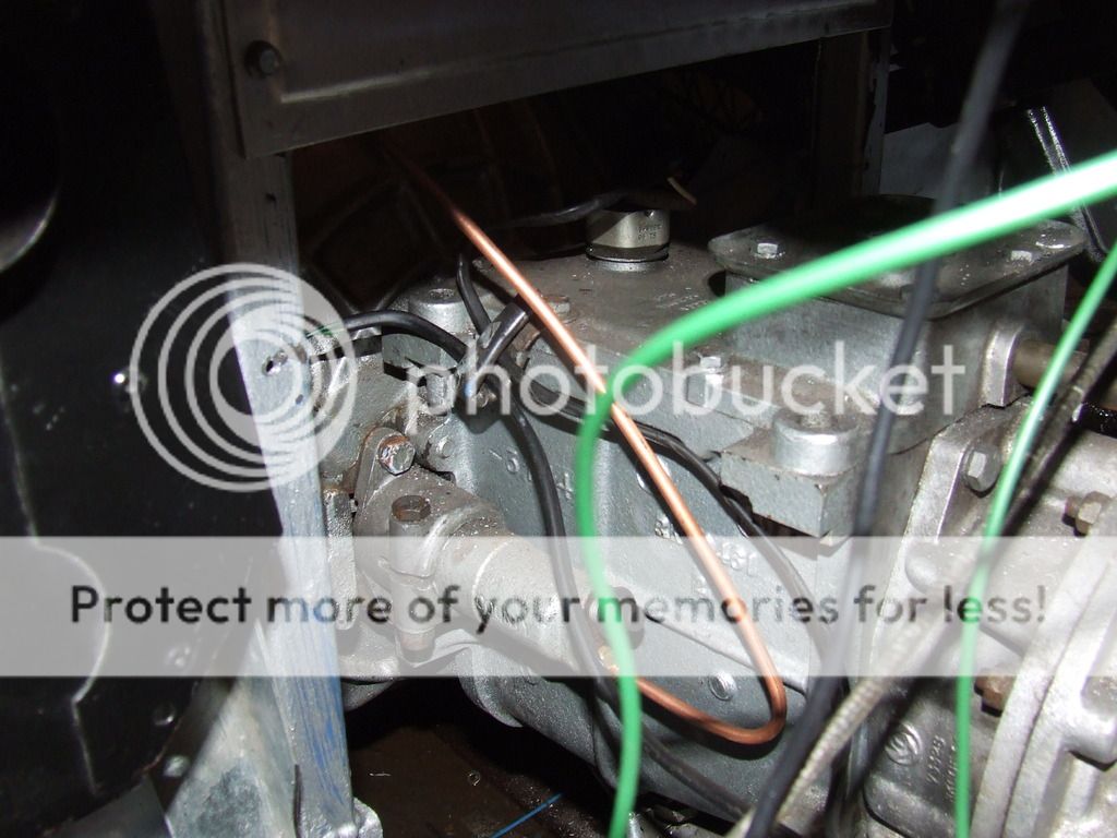

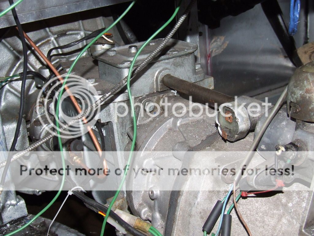

Thanks Mick I wish it was that simple as you can see from the photos below (just) there is a inhibitor switch in front of the gearstick the reverse light switch is just behind the gearstick (two wires going to it) at the front on the top of the gearbox there is another inhibitor switch? this is where the selectors should be so I have wired up to that one.
[IMG] [/IMG]
[IMG] [/IMG]
It may or may not be right I'll find out the first time I drive it?

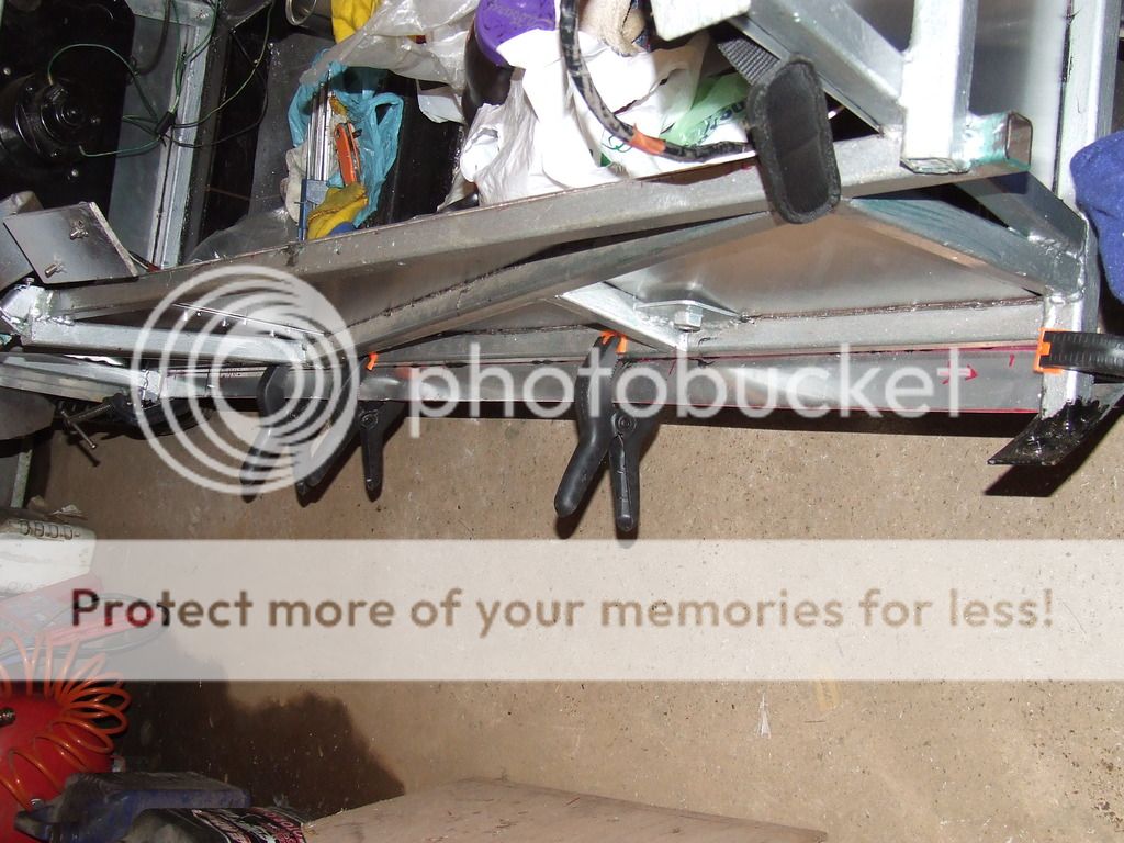

today I installed the bottom fillets to the frame these will be sealed with P.U. adhesive once the body is on
[LMG ][/IMG]

That circular (ish) switch in front of the gearstick seems to be in a redundant position. Have you tried a continuity test across the terminals with the 'box in each gear? Be interesting to find out what, if anything, it does!
16th September 2015, 16:42
Join Date: Mar 2015
Posts: 395
T checked them today and you're right the one by the gearbox would have power going through it in all gears the one at the front only in 3rd and top so hopefully that should do the trick
