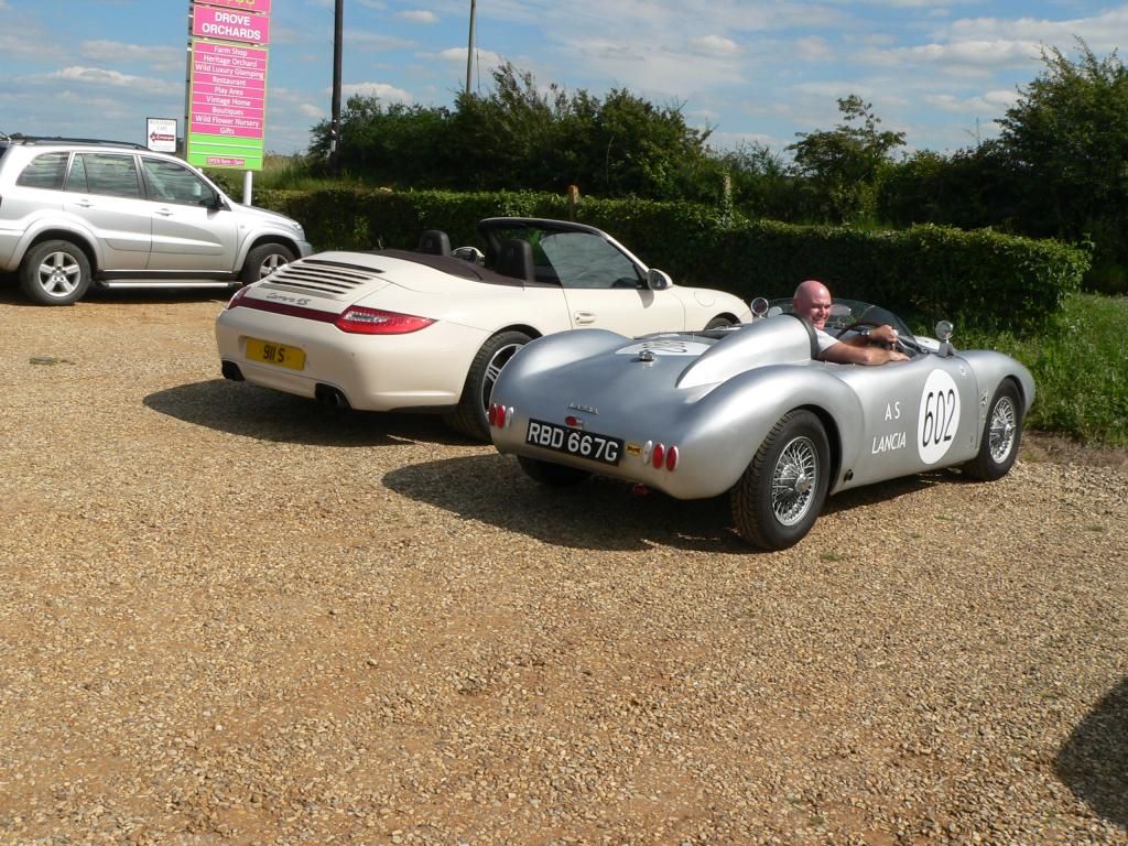

Scottie the car looks and sounds awesome. If I can get anywhere near that with mine I will be very happy.

Great Scottie (always wanted to say that), it does look and sound the business. I Love the Tudor building in the background too, incredible when you think that it was built at about the same time you started your build...
I'm impressed that you even managed to get a (minor) celeb to drive it for you too. How much does Lionel charge these days?

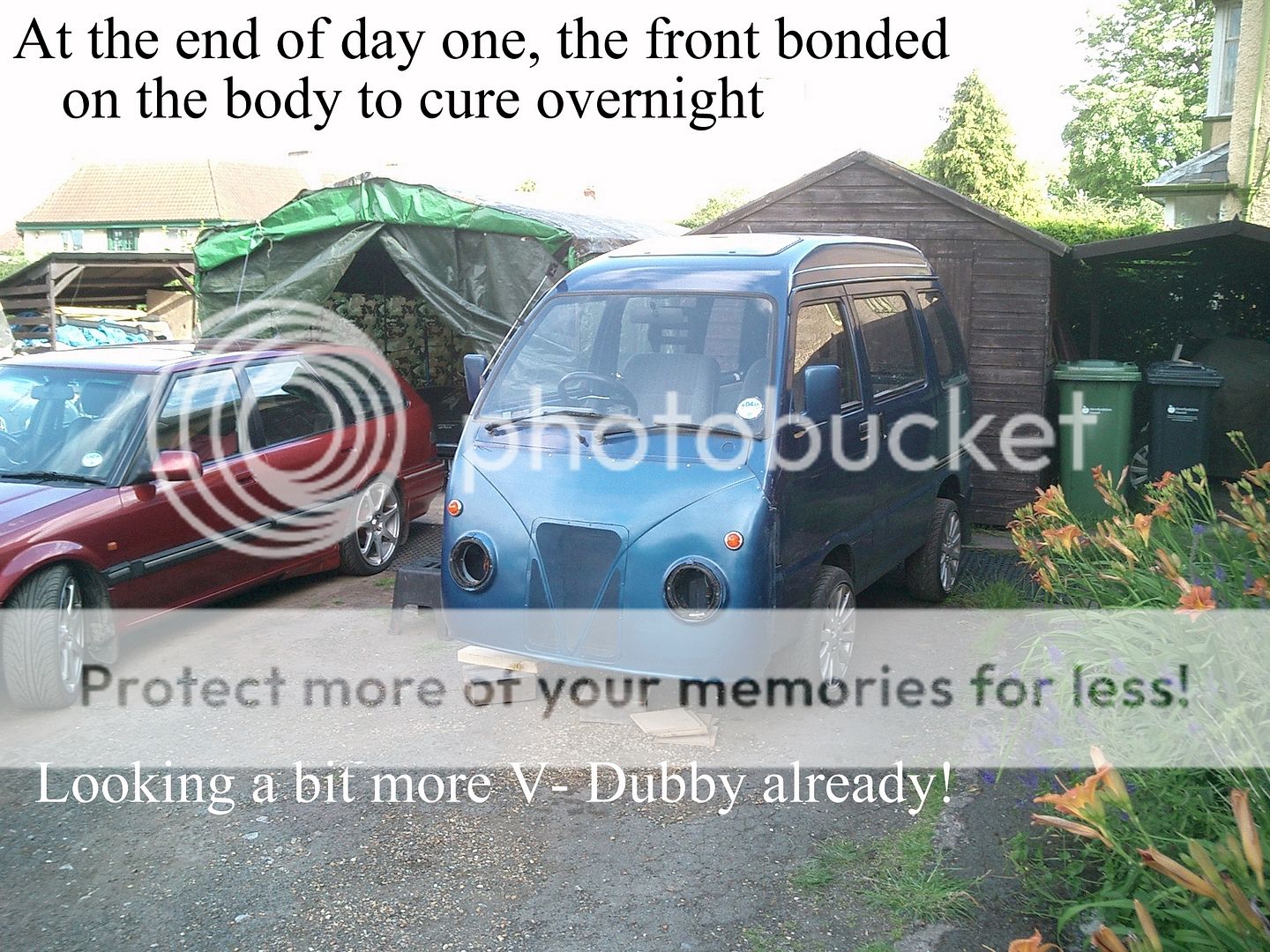

Monday was Van-day.
Not strictly Tribute related, but I know several people have expressed interest
in this project, so here we are.

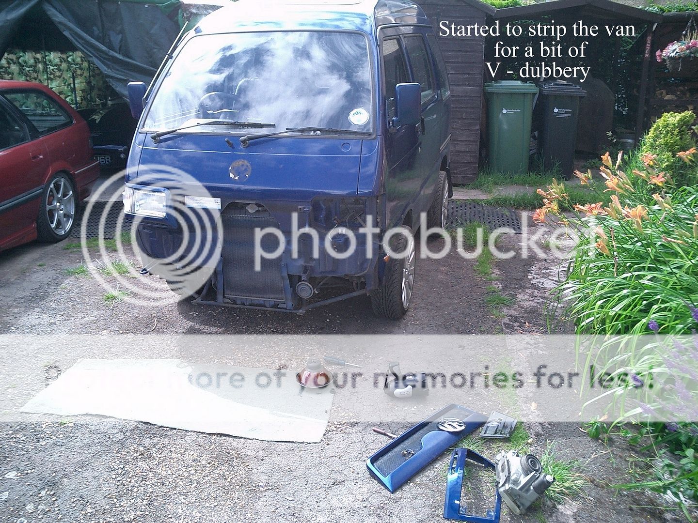

I stripped the van front off today, and the lights and indicators, and had a trial-fit of the "new" font.
I needed to extend the wiring a bit as the new headlights are a lot lower than Daihatsu intended them to be.

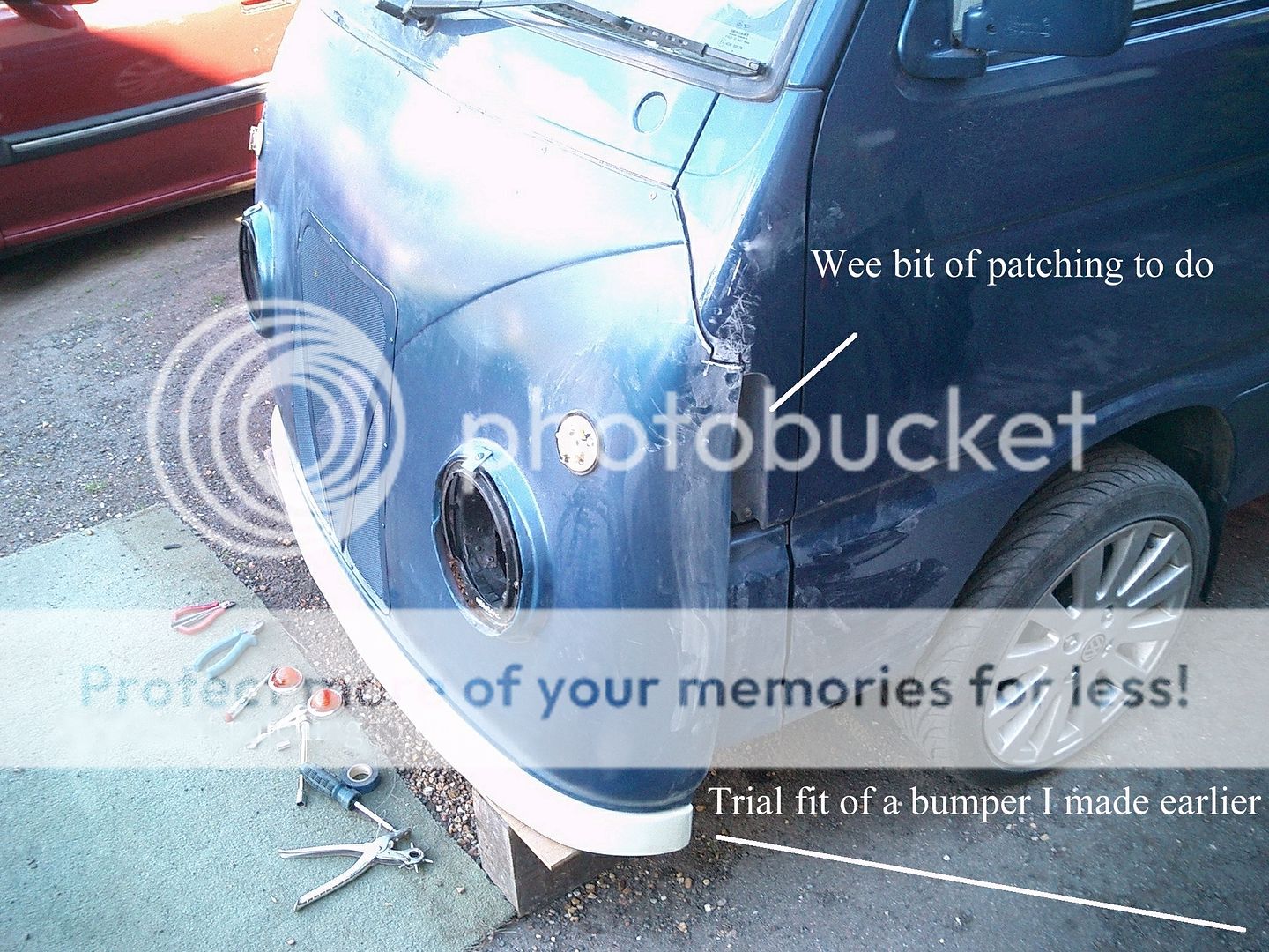

I was disappointed at the fit round the sides, but not overly so.
I fitted in on with loads of self-tappers to a good sound fit, then took the front off, roughed it up a bit, and Sika-flexed it back on permanently.
I will take out the screws tomorrow and feather the edges and fill it.
It will look very cute when finished!
