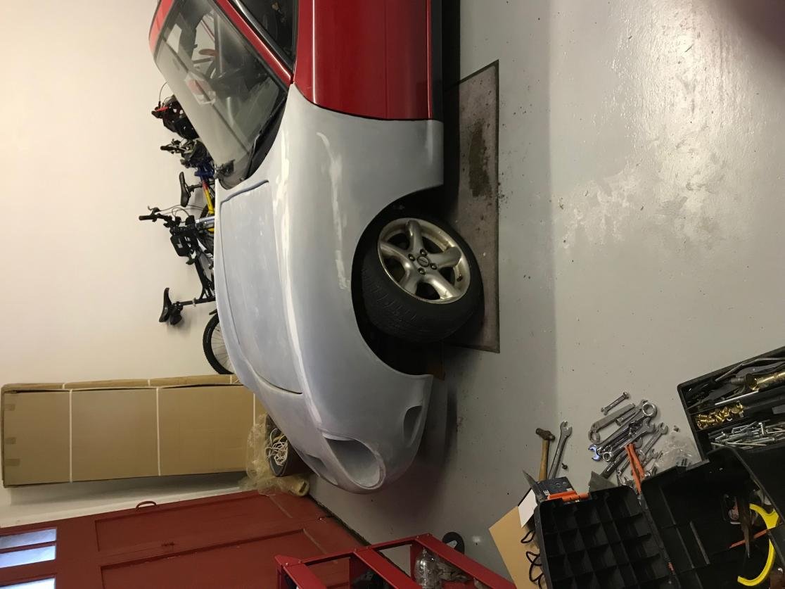

30 May 2018, 12:18pm
First pictures
30 May 2018, 12:20pm
First pictures
30 May 2018, 1:32pm
glad you have decent brakes terry :)
the front does look good so far though

31 May 2018, 10:25am
First pictures
Hi Dave, bloody can't work out how to turn the picture around! All good on my pc then they rotate when I put them on, think it has something to do with the size?
