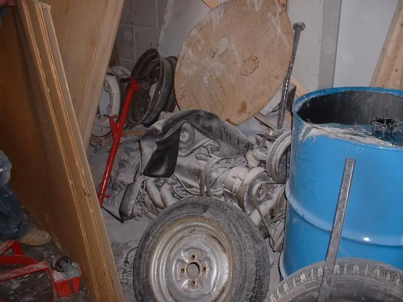

I have decided its time to put a car together for myself....
I have acquired a 1963 Herald Chassis and a tatty Mk2 Vitesse rolling chassis.
I am going to upgrade the Herald with some of the vitesse parts and throw a Rover V8 into the mix but set it back a little for better weight distribution...
On top of this is going a Cordite body...the shorter body will help me with some extra engine room . A roomier Cordite bonnet will also be used but will need the area between front arch and bulkhead stretched about 8'' to deal with the longer Herald wheelbase...
I am not sure what issues this combo will throw up yet and the plan may change a little along the way , but thats the plan at the moment....
Updates as and when ....but heres my starting pile...

Are they Maestro/Montego wheels on the back of the upper chassis?
If so, that could be the source of the larger steels with 92.5mm pcd that some builders are looking for.
