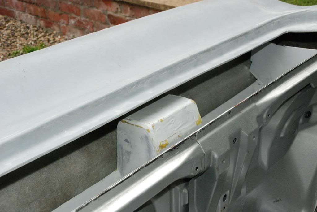

Okay, what's going on here? This is the rear panel extender fitted directly onto the inner bumper and it sits too low.
28th May 2013, 19:44
Posts: 576
Something is not right somewhere with the alignment mayby its a MK 2 thing, you are entering pioneering terretory, as no body in the world is building a Tribute MX 250 C on a MK 2, and apart from Chris and his demo nobody has built a 250 C on a MK1! Chris has sold three of thers kits and the other one has not started, at least not on here. But hay we struggle on, as long as the rear is supported (mayby spacers?) and looks aligned to the body, it should be ok, mine looks like this.

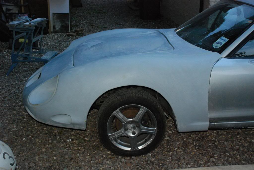

Ignoring my rear end problems (Oooh, Matron!) first, very basic, dry fit on the front after much cutting, swearing, worrying and comments such as "Should have bought a Mk1" from my ever helpful wife.
Excuse the cockeyed bonnet, that will be pulled into place by the locking pins.
Much happier with the shape around the wheel arches.
28th May 2013, 21:50
Posts: 576
Front looks fine, our German frends are the one's to ask about MK 2's but they are both hard tops and the rear is very diferent on the 250 C, ingnore the wife, what do they know, the car you are building is only car of its type in the world.
28th May 2013, 22:17
Join Date: Jan 2013
Posts: 429
Cheers Tony, need all the encouragement I can get, although I didn't think I'd get the front end to a point where it looked half decent and it's nearly there so I'm sure the back will be a soluble.

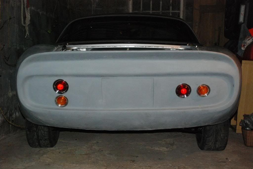

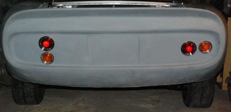

Decided to use the rear lights I got from a local scrap yard. Think vertical rather than horizontal looks better.
30th May 2013, 22:02
Posts: 549
Just watch out that they meet the legal requirements, this westfield sva guide is useful http://westfield-world.com/svalights_rear.html
31st May 2013, 08:03
Join Date: Jan 2013
Location: Germany
Posts: 188
I like the horizontal version but a little bit closer to the side
31st May 2013, 08:30
Horizontal does fill space better.
31st May 2013, 08:33
Location: London
Posts: 64
last pic definitely looks best to me, horizontal and nearer the side. presumably separate fog and reversing light mounted below bumper (thats if fogs not incorporated into those main units)?
