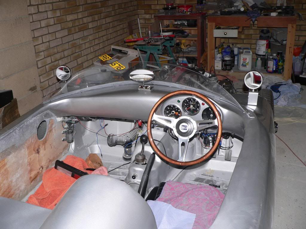

PS Yours, Mister Towed, is rather better balanced in profile, but I think your (larger?) wheels help. Love the dash too.

Dash is a moulding taken from a Porsche 550 that I chopped about and blended in. Works really well and suits the car imho.

Personally, I liked your dash so much I tried to copy it
20th December 2015, 18:01
That looks a lot better without the hump. GTO dash is a good starting point too.
