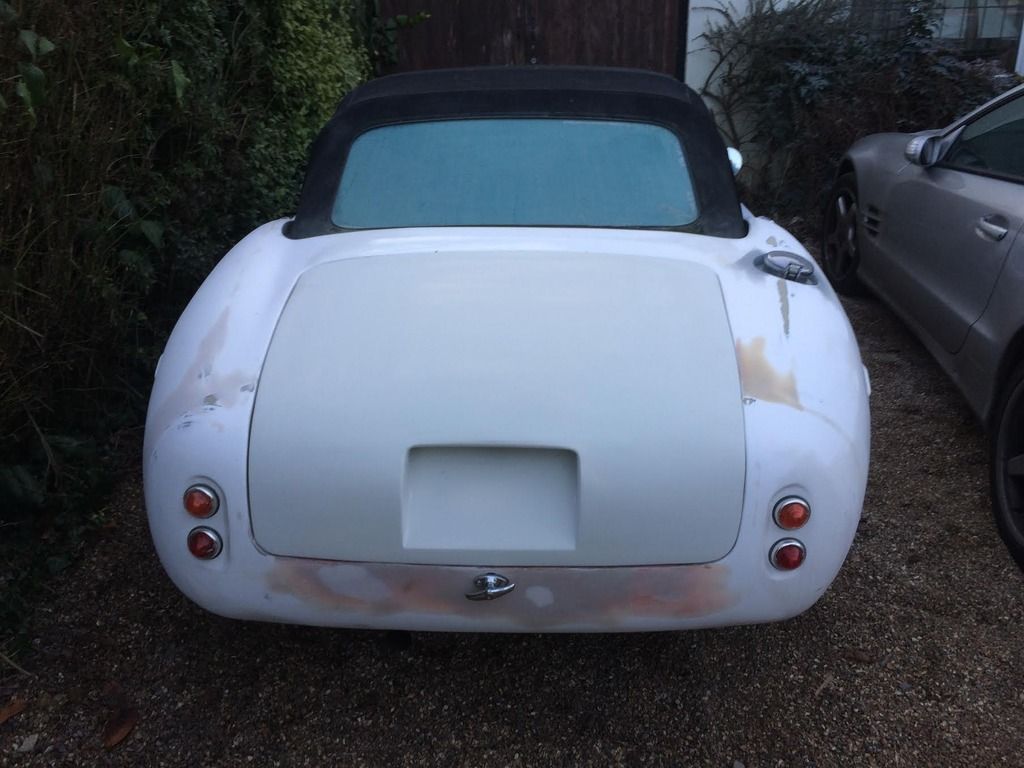

My boot lid hangs over the rear panel by about a cm. I had put a slice previously and re glassed it when it was clamped with a couple of ratchet straps but it didn't make much difference.
I came to the conclusion that it may be down to the fact that I have opted for the far superior and better looking internal boot hinges! Nobody else has reported any problems in this area. I took the belt sander to the lip on the top of the boot and levelled it all up plus a bit more so I could try and move the boot lid back to try and make it sit flush at the back. Again a small improvement but no enough.
I then covered the bottom of the boot ld with duct tape to prevent GRP paste sticking to the lid including the return. I then did the same to the closing section (where the striker plate sits). trimmed it of fish to the bodywork. I then built up the rear body section with GRP paste using the lower section of the boot as my guide. Just before it went hard I ran a stanly knife along the join.
It has worked pretty well and now the rear body has exactly the same profile as the boot lid and it has also given me a much better closure gap.
I also built up the passenger door skin to close the gap at the top to allow the fitment of s window rubber.
This gave me plenty of time to continue sanding the rest of the body shell because the GRP took ages to go off due to the cold even though I had put extra hardener in the mix to help it go off.

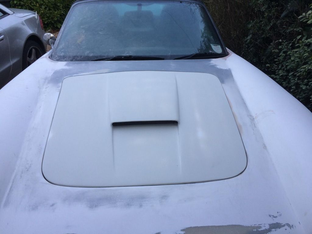

Slow progress, lots of filling and rubbing down. I have built up the area under the boot lid and it looks much better. I have also given the boot and bonnet 2 coats of reface and rubbed it all down. Very pleased with the result but am not going to say too much in case it all goes tits up when the final coat goes on. Took 1/2 litre to do both panels, 2 coats, doesn't go very far. Almost finished the rear and front sections ready for the polyester coat. Just the bloody doorskins to do which are going to be the hardest. Thought I would leave them to last, if I started with them I might sell it and buy a Nissan Micra!
Boot gaps are better than in the picture but not worth lining it all up and it's going to be on and off more times than a whore's knickers!

Out in the gazebo today, sorry the professional spray booth! A coat of flow coat to the inside of the front clam and a coat to cover the dark blue on the small bonnet. I gave the bonnet a good clean with meths to get rid of the wax from the previous for coat. All looks very much neater. I can confirm that light blue matches very well with green grass and a green gazebo. Someones going to be in trouble when you know who spots it.
I also cut some alloy brackets to hold the grill and grill surround. I have fitted the spots to these brackets so they double up for holding the spots and surround. I now only need 1 small screw in the underside of the surround to hold it firmly.
As soon as the flow coat is dry I will flip the bonnet and give it a couple of coats of reface and am then having a go at priming it before refitting everything to drive it to the painter.
I think I am going to cut the slots in the wing vent and fix stainless mesh behind. Sort of a compromise.
