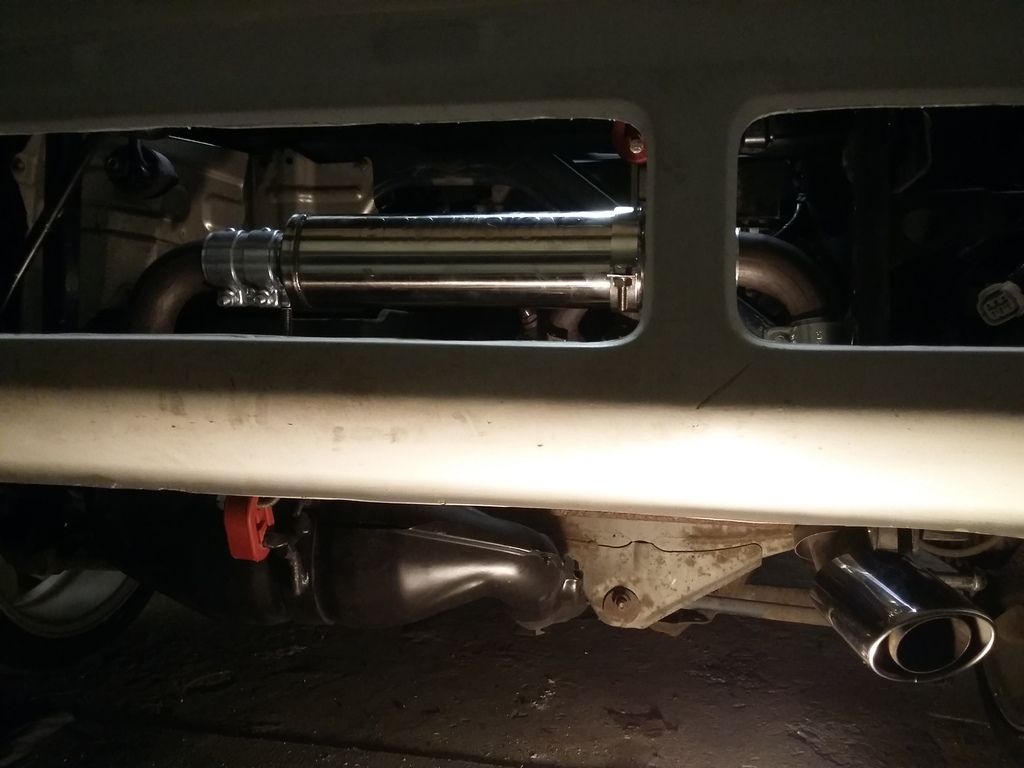

Made a new exhaust out of the old one and a new muffler
Fitted (although it needs a bigger exit)

Looking good, what's the noise like on the new silencer?

Little bit noisier than standard on tickover but its peppered with air leaks at the moment so could get a tiny bit louder. I've not sealed it up yet. It could be the noisiest thing in the world when I get to drive it but the plan for now is to have two exhausts. One like this (for MOTs and things), then another deleting the cat for when I feel like being obnoxious... which will probably be most of the time.

Fog lights - went for Rings as the hellas are just a bit too expensive for me at the moment. Could always just buy a set of hella covers I suppose.
And my new tail pipe. 3.5 inch... not too ott.

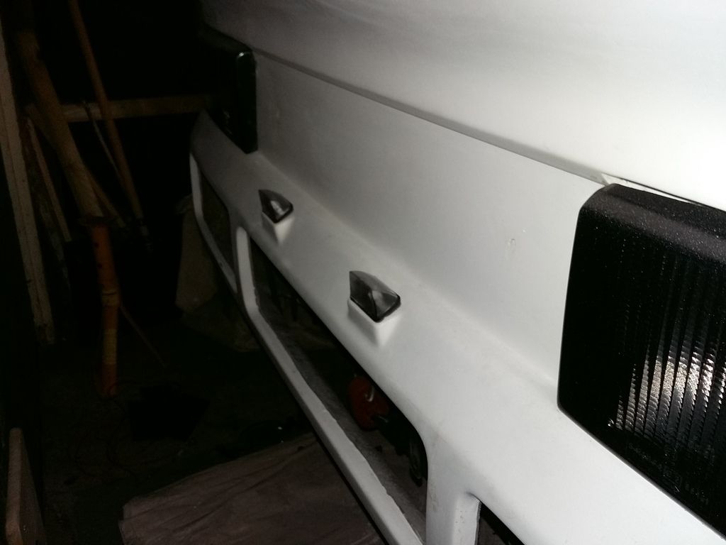

Also cut and fitted the number plate lights. These are Peugeot led units. Look good and seem to aim in the right sort of direction.

mrs200 number plate lights
i used ford transit connect number plate lights they fit the raised area spot on, loads on ebay , ive got a 08 tranny lwb here at the moment i am working on they look the same as well. glad your makng progress keep at it !!

I'm using the Transit Connect also
