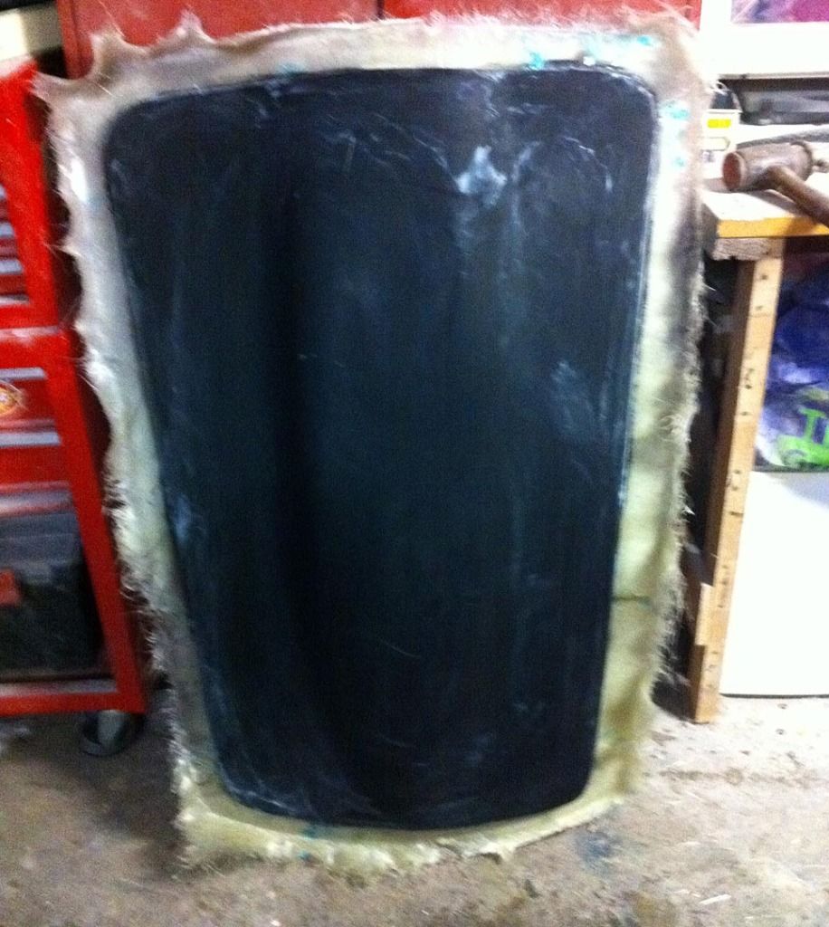

We got the moulds for the internal panels on the A352 started today. All of the joins between the individual parts were filled and the tech screws that were used for fixing were capped with mirror screw covers so they will echo the rivet detail on the exterior of the car. The moulds are split into 3 parts and will go along way towards a total replacement GRP tub option that will be offered alongside the retention of the steel Spitfire tub option.
Gelcoat and paste applied.
Matting applied with reinforcing bar to stop flexing of the rear panel.
We are planning to produce a finished set of new internal and external panels over the next week or so, along with the acrylic and steel hinges, to have a complete A352 kit package ready for the first customer to pick up. Not too bad when we only started on the 15th October!

Interior moulds taken off the car, just need a trim around the edges and remove all the black paint/pva.
Bonnet No.1 out of the mould

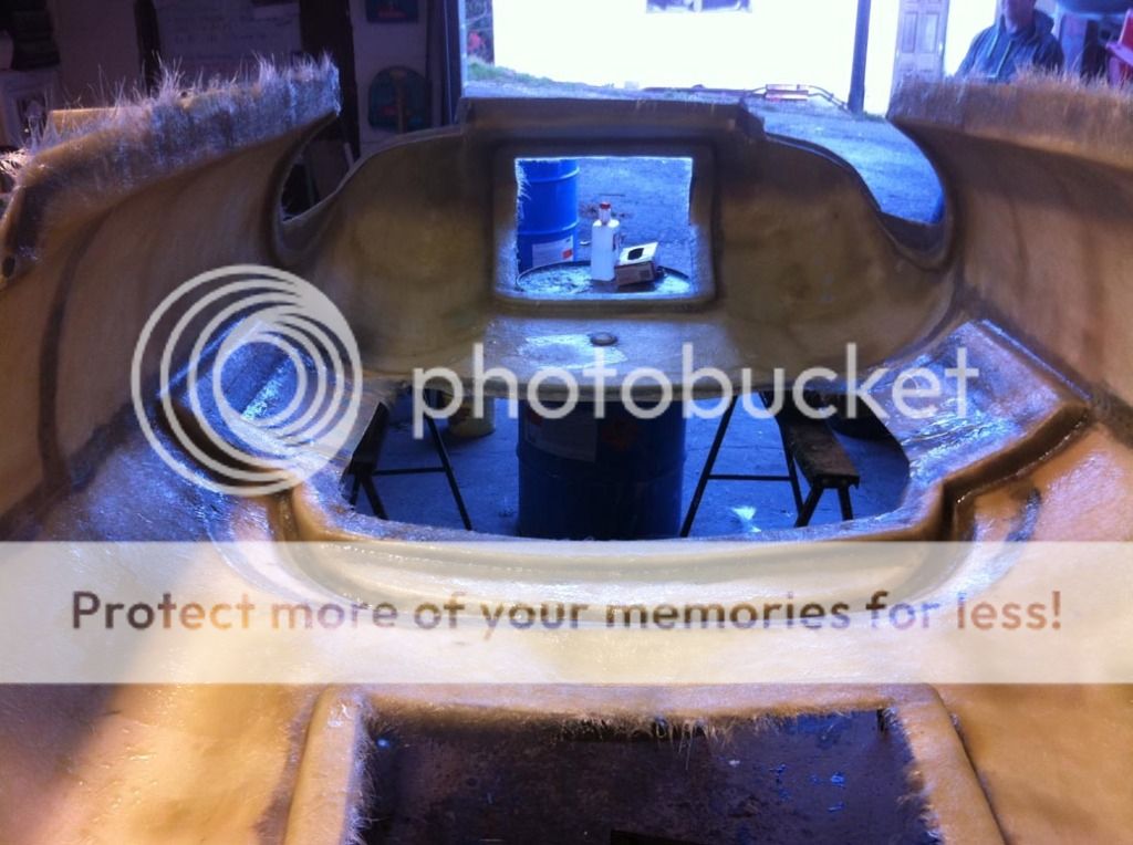

We laid up the 1st production body today. Once trimmed it will go back on the Spitfire in the workshop for final finishing work on door hinges etc.

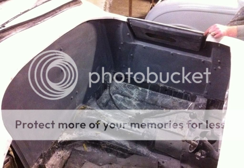

First set of internal cockpit panels from the moulds today
16:30 - One empty Spitfire cockpit.....
..... 16:35 - One panelled out Spitfire cockpit. Simple . (Doorbars and hinges would of course normally be fitted first.)
