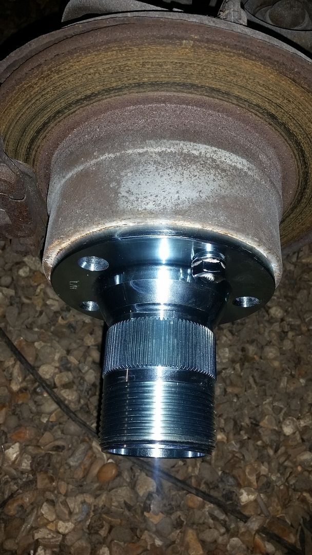

Update on the new hubs for the 250 SWB
This is the customers E-type 'curly' hub wheel powdered coated in chrome effect paint and fitted with a period looking tyre.
On Monday evening we are fitting the new hubs to check for clearance.

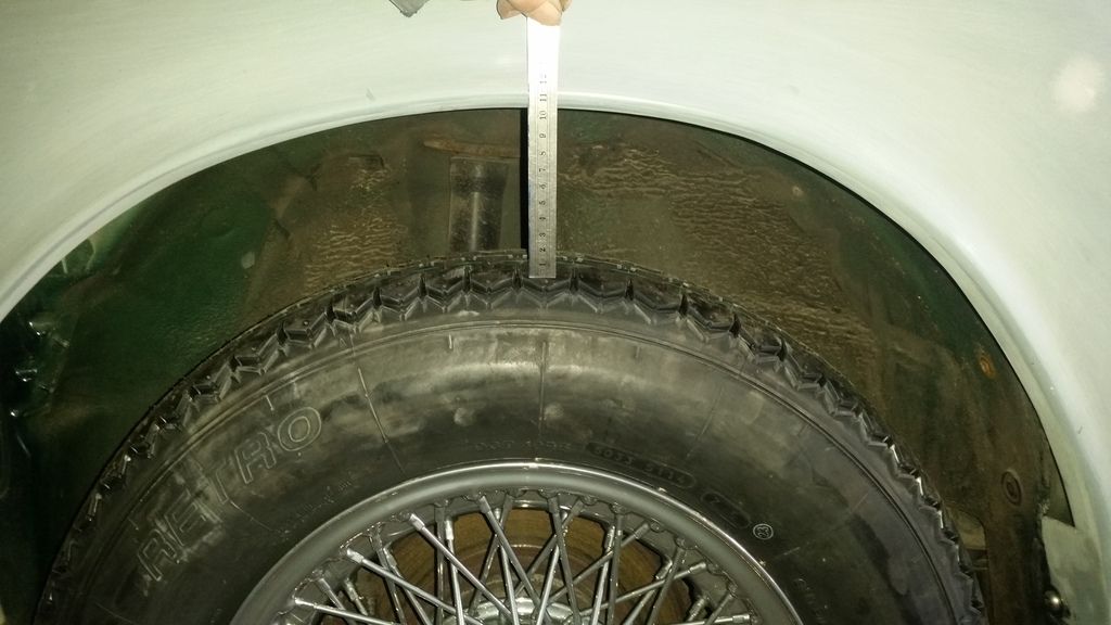

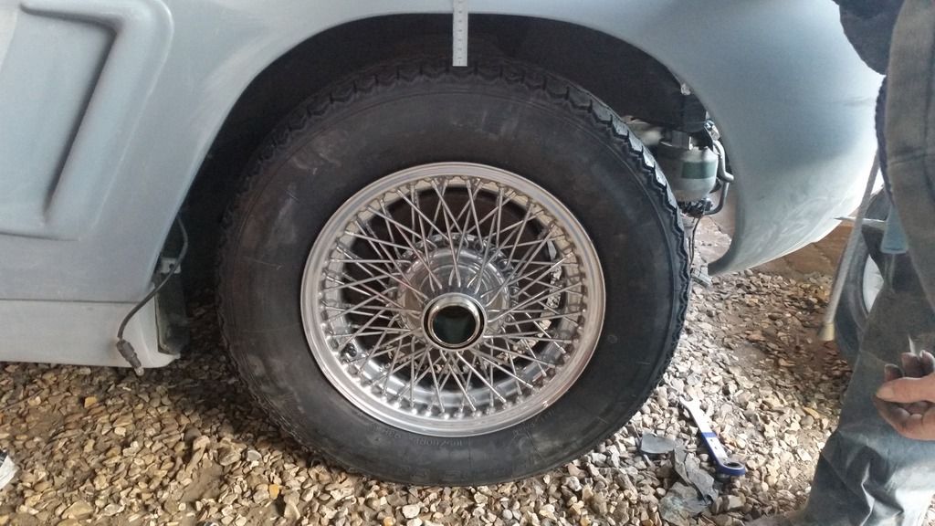

Well at last the newly machined, shortened hubs have arrived. This means the wheels fit under the arches (just, on the rear). The spinners however will stick out of the arch.
6th February 2016, 19:24
Posts: 607
The problem now is that the 185 tyres the customer has used are shallow in profile and the vehicle will need lowering a lot.
6th February 2016, 19:25
Posts: 607
The rear is a bigger drop
6th February 2016, 21:16
Posts: 2,149
https://farm8.staticflickr.com/7579/...f7aa00e5_b.jpg
The front looks quite similar to this original , maybe a 40mm drop needed on the rear ?
