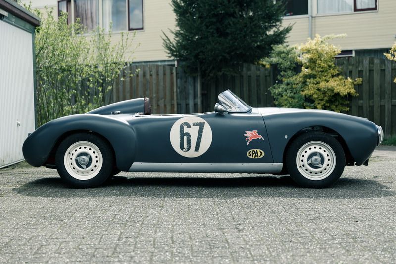

Looks great!
18th April 2017, 07:16
The taller flyscreen looks great Jerome. Wouldn't pass the annual MOT inspection here though as it would need to be safety glass and have windscreen wipers if the driver's line of sight is below the top of the screen.
I was also surprised how much the Midget screen suited the lines of the car. I know it isn't as attractive as the curved screen you've gone with, but I'd say it wouldn't look out of place on a Spyder if it had adjustable side pillars so you could alter the angle at will - raked back for best visual effect and more upright for long distance protection from the elements.
Nice work.
18th April 2017, 07:40
The first S*mmio had a slightly re-worked M&W 550 screen fitted to it , this was tweaked on the later models to become the more familiar one they all had ...A 356 screen will fit a 550 , so , it's not unreasonable to think a 356 screen would be close to fitting a S*mmio . The bottom line is different , but if you created a channel in the cowl to accept the screen base and recessed it below the bodyline , it might just work out ok ....this gives you safety glass and a decent surface for wipers ...The Triumph wiper system is perfect for being modified in regards to position etc too ...so with a little effort , the cars could be converted ok ..
18th April 2017, 08:28
Funnily enough my Spyder screen is currently sitting on my 356 body while I make a few modifications to the Spyder bonnet, and it pretty much fits the Speedster straight 'out of the box' (I'll take a pic or two later).
That suggests that the 356 Speedster screen and frame would fit a Spyder without too much trouble and would look pretty good imho.

I think the taller screen is a nice touch and keeps a little more of the snow off.
This was a full size Spitfire screen on a modified SAMMIO body.
A little high perhaps but the photo's are misleading and as Gary says it could be lost under a higher bonnet.
We plan on doing a full screen modification for the new SAMMIO ALPHA.
There are a few reason for this, the main one is to assist with the fitting a roof making the car even more desirable .

Okay, here's the Spyder screen on the Speedster body -
Fits pretty much as well as it fits the Sammio, so a Speedster screen and frame would certainly fit the Spyder if you wanted a low windscreen.
18th April 2017, 20:08
Posts: 5,058
Looks good to me.

Dito, it blends in well with the body, looks better than a full height screen.
