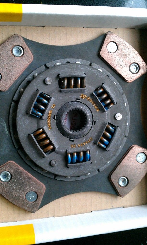

It has just had its MOT and we put a racing clutch in, to help cope with the sideways action.

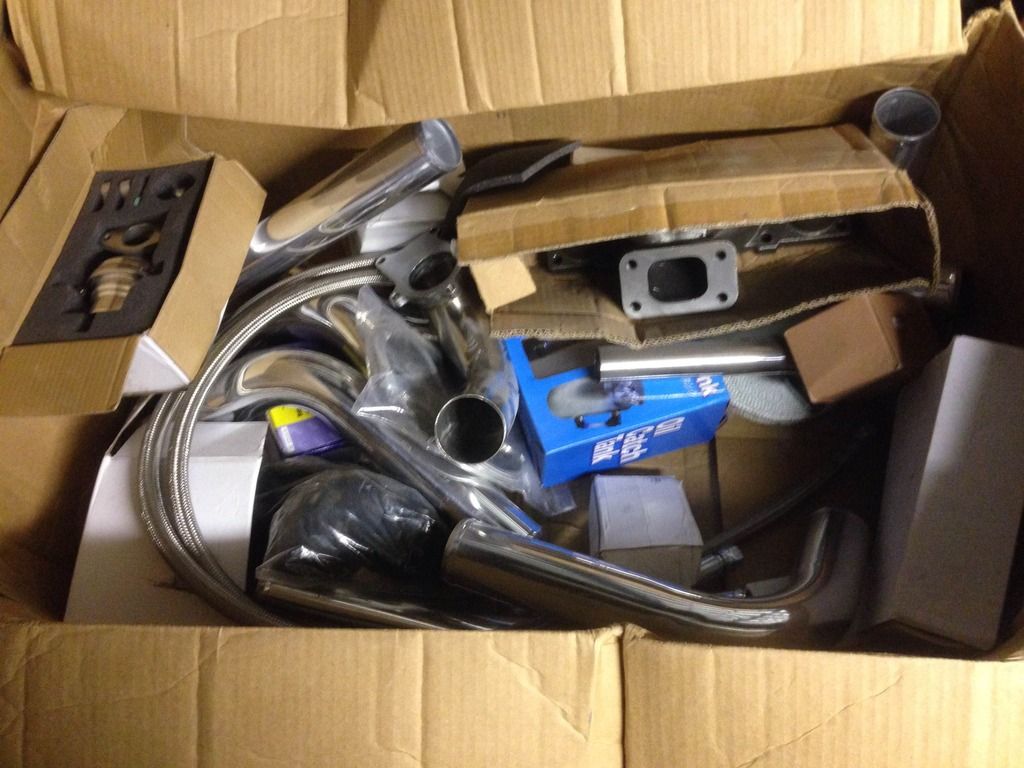

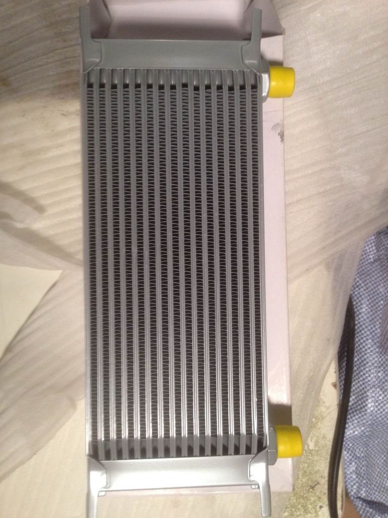

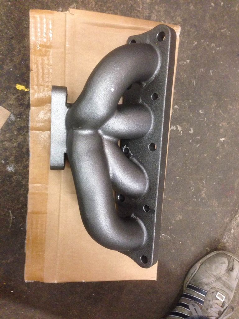

Just been digging some parts out.
[IMG] [/IMG][IMG] [/IMG]
[IMG] [/IMG]
[IMG] http://[/IMG]

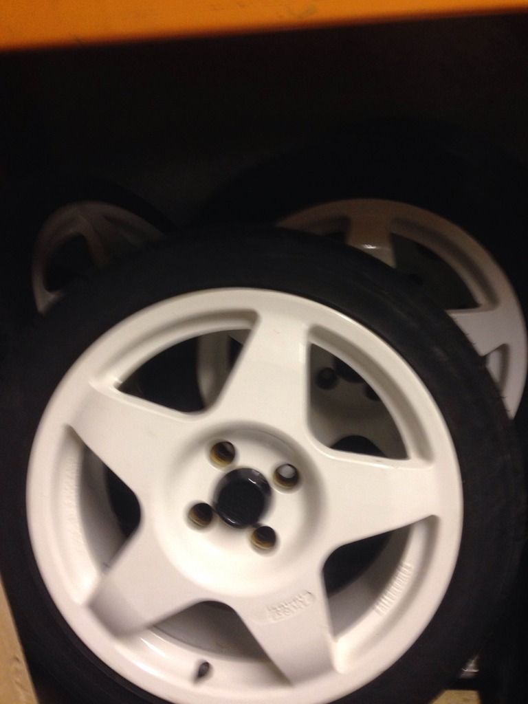

I want your wheels!!! Compos?
12th October 2017, 21:01
Join Date: Oct 2016
Posts: 182
Yes, MO 5s

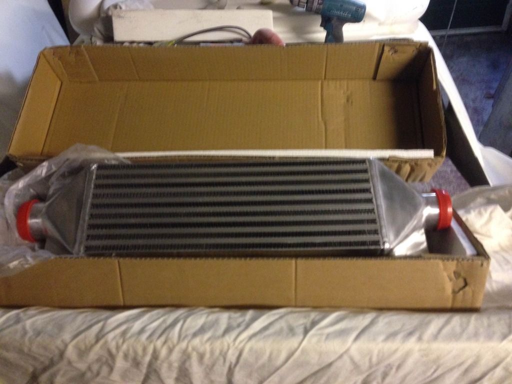

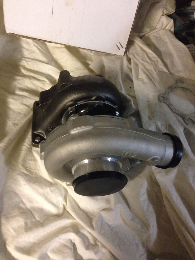

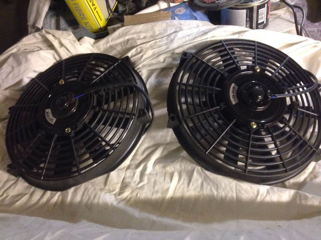

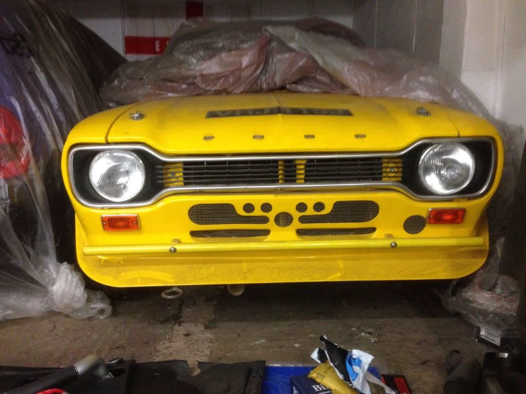

Just been digging some more parts out
[IMG] http://[/IMG]
[IMG] [/IMG]
[IMG] http://[/IMG]

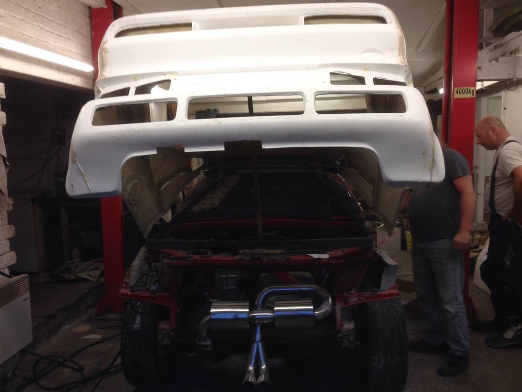

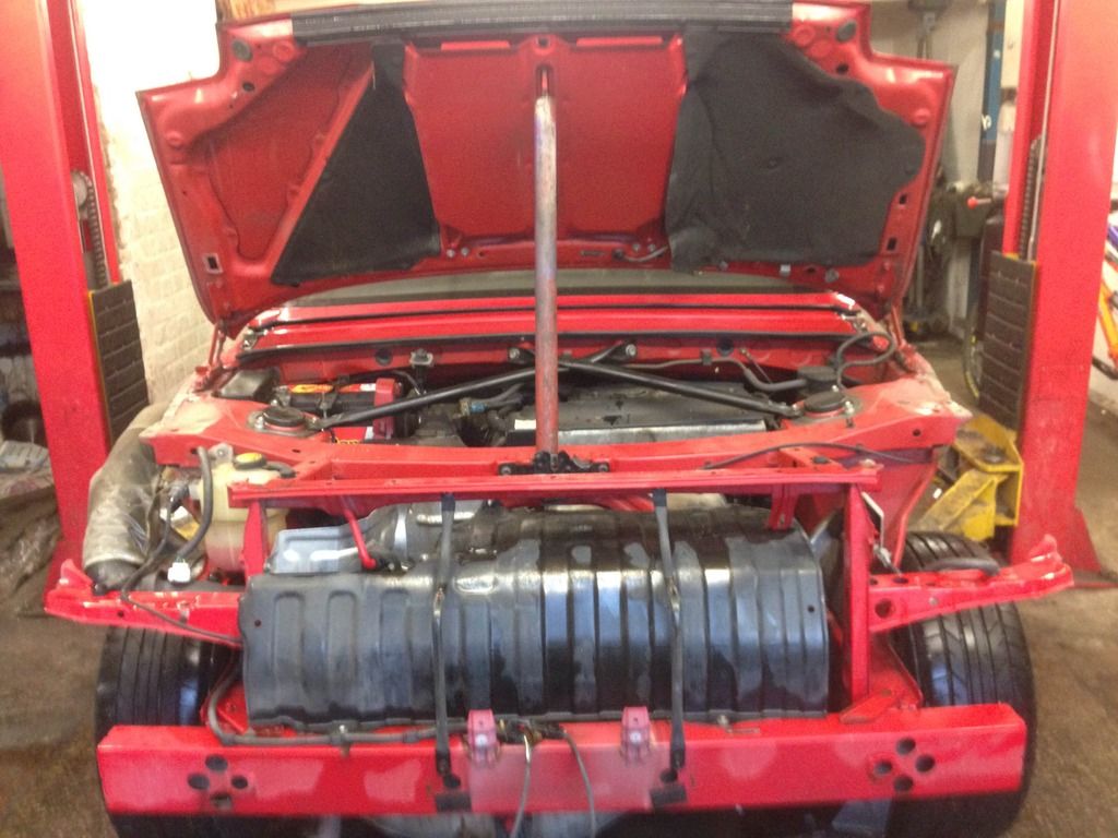

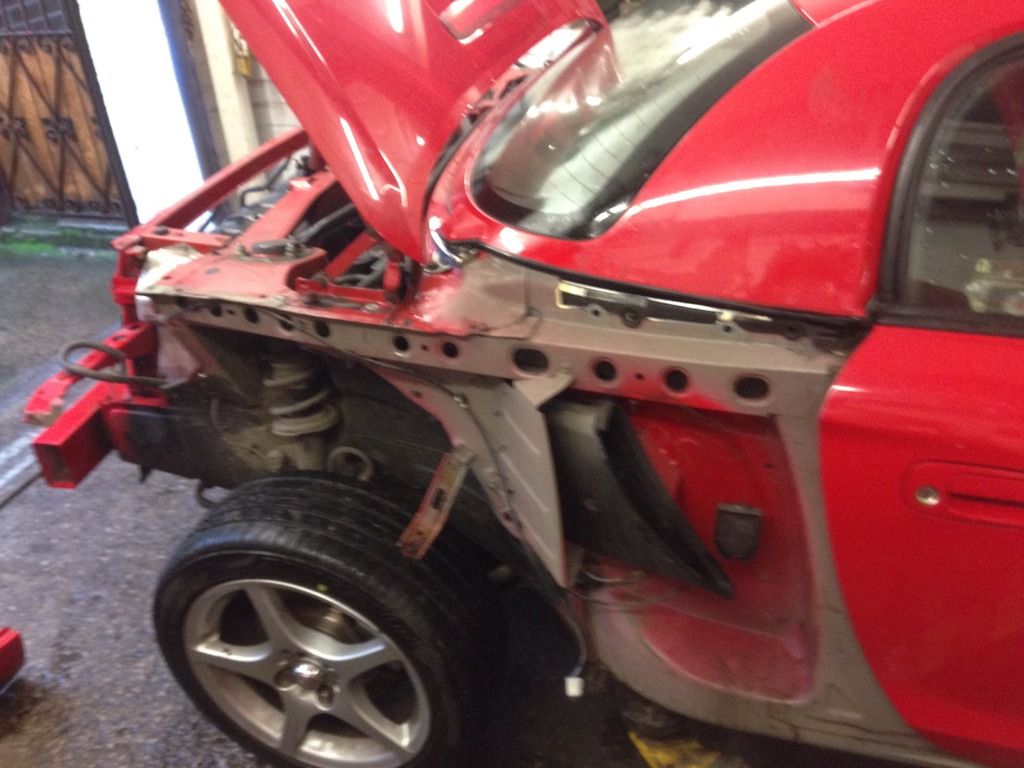

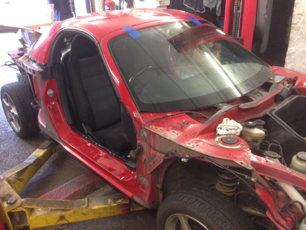

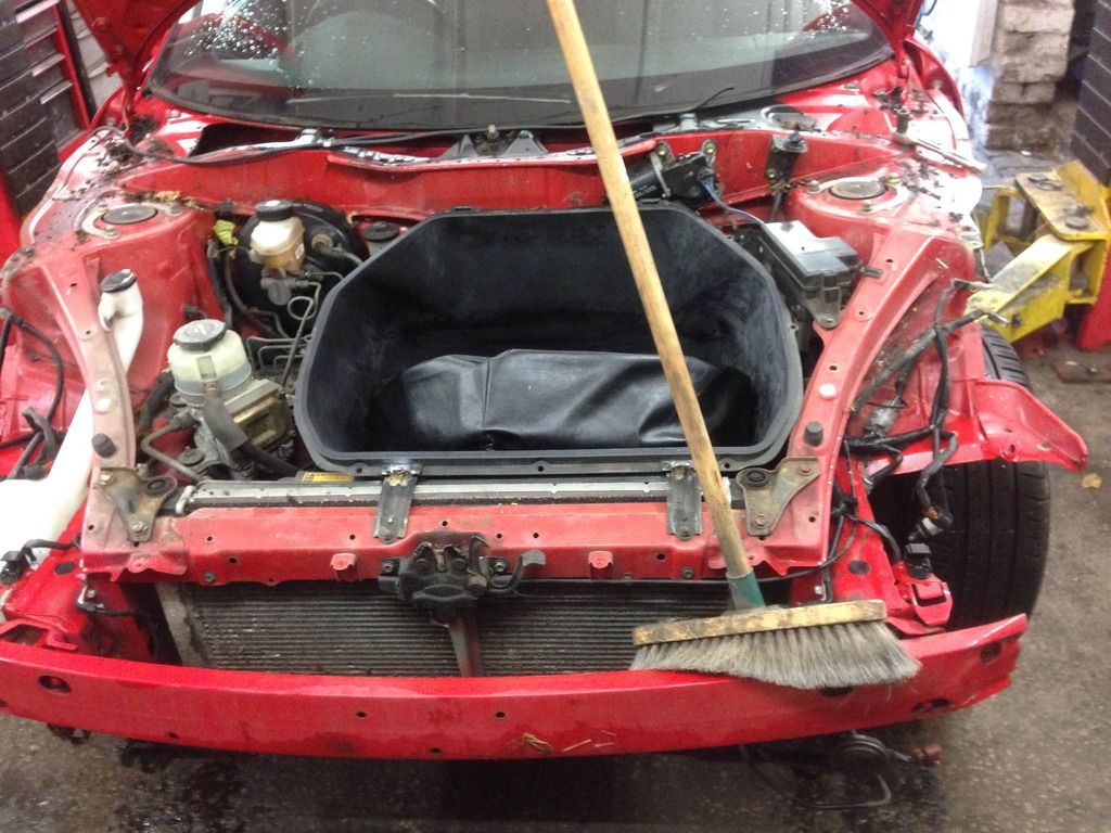

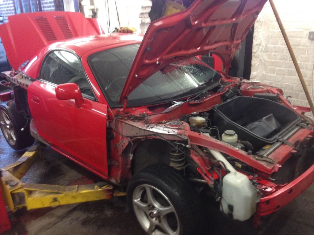

The strip down has begun
[IMG] http://[/IMG]
[IMG] http://[/IMG]
[IMG] http://[/IMG]
[IMG] http://[/IMG]

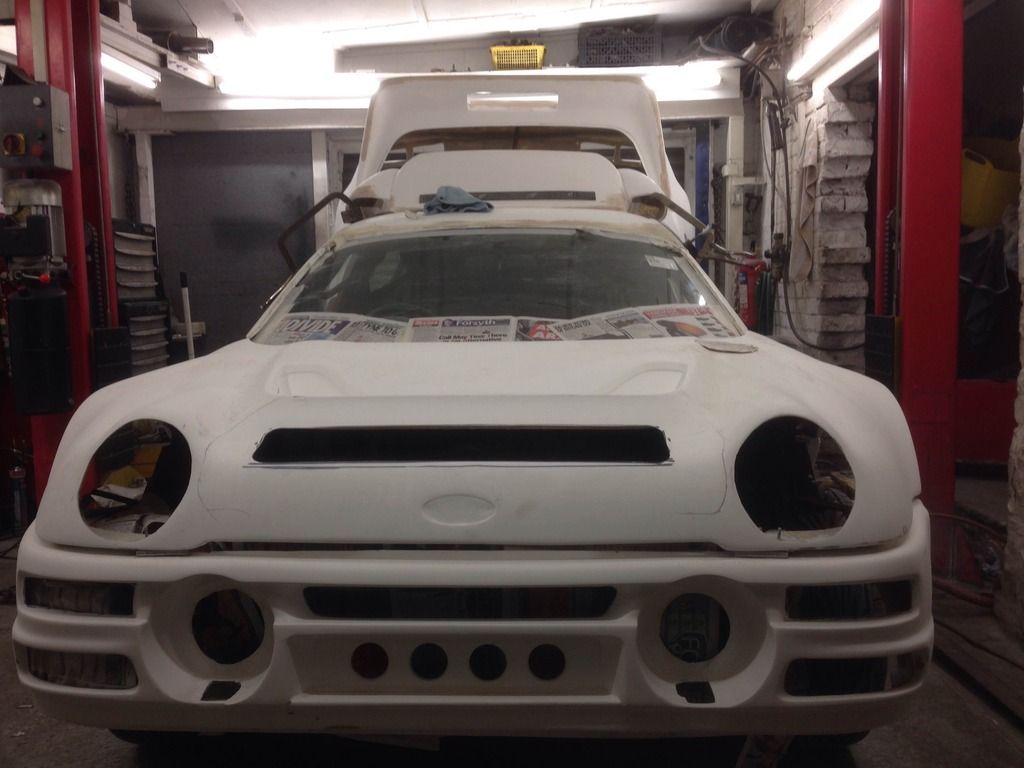

The front screen had a small chip in it , so i thought i would get it changed before the kit was fitted.
[IMG] http://[/IMG]

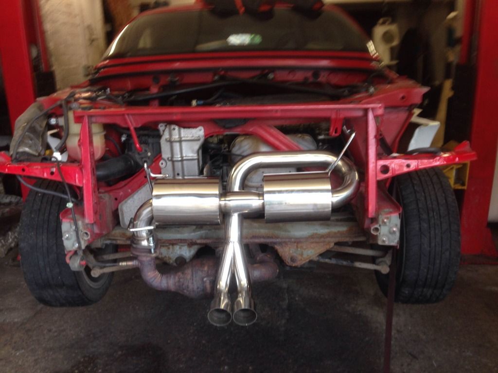

Also fitted the new exhaust,
[IMG] http://[/IMG]
we have been having a play about with the body kit, can't believe how badly out some of the fit is.The front bumper support bar looked like it was for another car.Also put on the new wheels, will get the spacers on the back later.
[IMG] http://[/IMG]

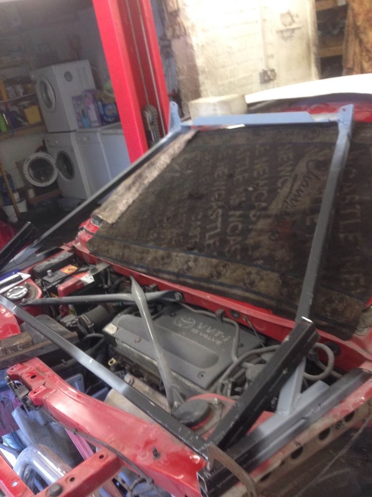

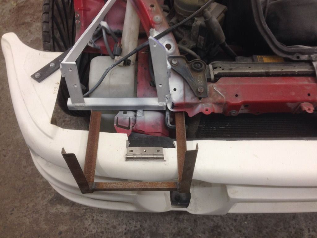

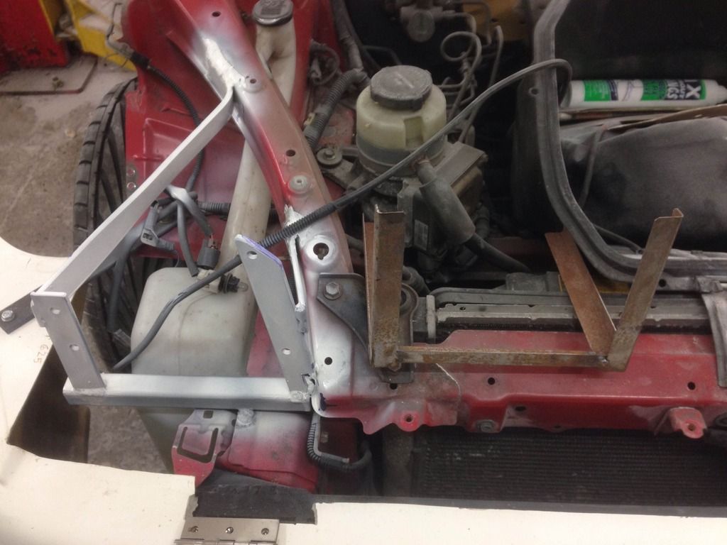

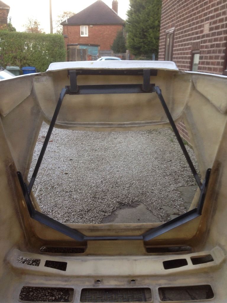

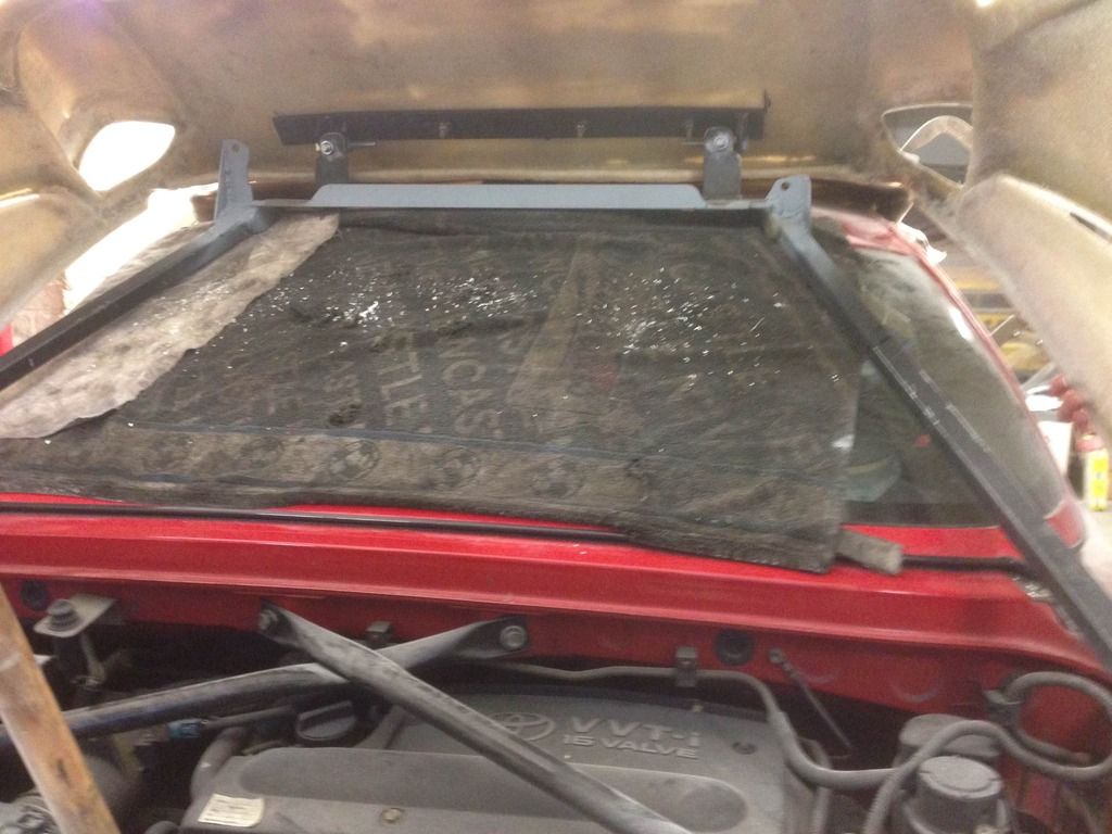

Had a mad few days on the car, finally got round to sorting the opening clam out.
my mate made a frame for the clam as the one supplied was not up to much
The intercooler is mounting on the top
[IMG] http://[/IMG]
Then a frame was made to support the hinge system which was done with rose joints
[IMG] http://[/IMG]
[IMG] http://[/IMG]
[IMG] http://[/IMG]
And i love this view
[IMG] http://[/IMG]
26th October 2017, 01:24
Posts: 1,401
Nice!
26th October 2017, 20:17
Join Date: Nov 2016
Posts: 228
The hinged frame looks great mate! What have you done with the rear crash bar to get around that?
26th October 2017, 20:43
Join Date: Oct 2016
Posts: 182
Hi Nick
We have got rid of the back part of the frame that was supplied and created the angles in the framework so that the clam would clear on the backs of the lights.
The small bar right at the back is to support the clam when closed, this will have a rubber strip fitted to it.
The bars running up the window to the roof at angles support the intercooler and also the hinge assembly for the clam.
The clam is on rose joints that pivot from the intercooler bracket and the angled framework at the rear of the clam does not lift, if you can picture it

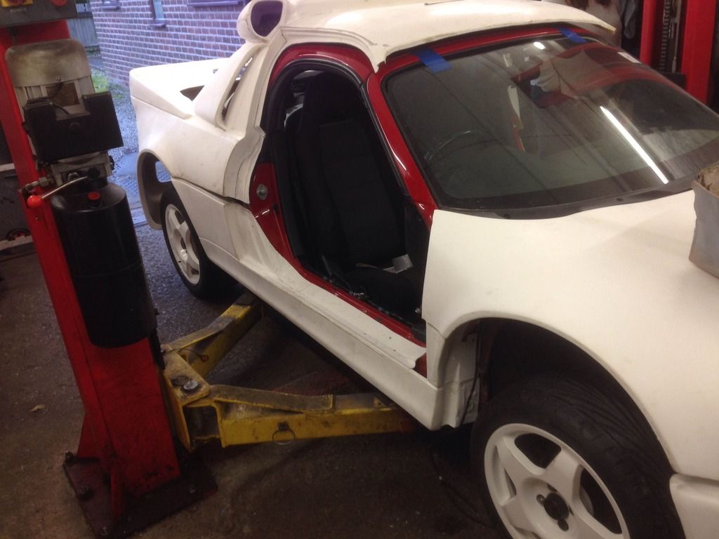

Just need to get the door skins done tomorrow and its ready for paint over the weekend. I must say that it has gone together a lot better than expected when i saw the tolerances on the kit and its quite a good fit now
27th October 2017, 20:51
Join Date: Oct 2016
Posts: 182
Got the door skins on today, what a long job that turned out to be.
Finally got the pod mounted
[IMG] http://[/IMG]
[IMG] http://[/IMG]
should be getting some paint on over the weekend.

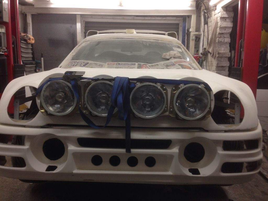

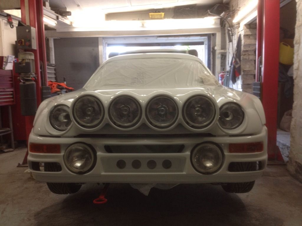

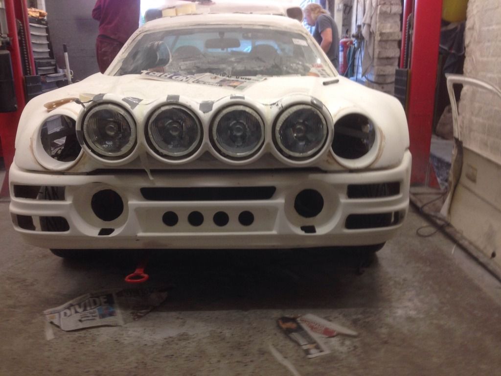

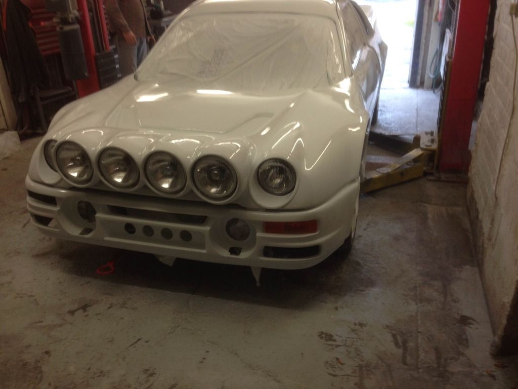

Called in today and had a look at the paint, just being buffed and polished but looking good. The lights are starting to be fitted so i can drive it home in a couple of days. Not fitting the rear window until the engine bay has been painted.
[IMG] http://[/IMG]
It's very white, Needs some other colours to help break it up. Just getting the lights in the right places. As there are a lot of them.
[IMG] http://[/IMG]
