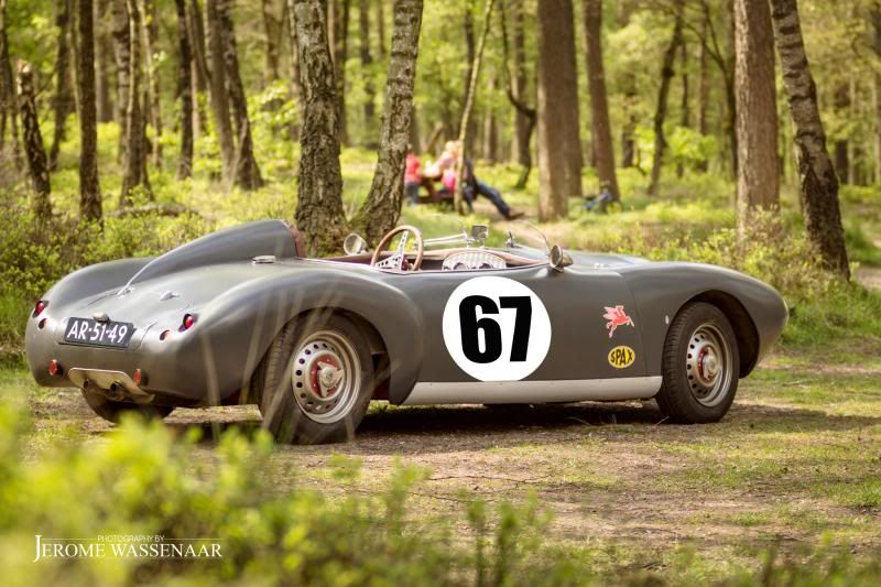

New update after a long time. Been busy with other cars (camper, 2cv and a Pinto engined Herald 13/60)
The gearbox is overhauled and it is now shifting very well.
Lots of minor problems; cooling, electric and a lot of other things are solved now.
Today we've added some stickers and took it for a ride.
Next jobs to do....
The clutch operates only when to pedal is completely down to the ground and the handbrake functioning is really bad... really bad.
So it is still not completely finished.
Some pics from today and a small photoshop for a roundal.

Nice car, nice setting and excellent pictures Jerome. I guess photography is your day job.
