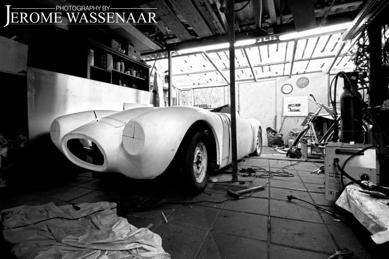

We fitted the body and had a lot of problems with the fitting shape (?)
The left side (seen from behind) is at the bulkhead 2 cm's longer than the right side. Our bonnet is at the right side 2cm longer (so no problem) But we've a problem. We have a very big gap between the body and the bonnet. I've seen a lot of pictures of other Sammio's and some gaps are very narrow. Is this filled with filler before painting or is our bonnet very bad in shape?
Here a pic of our gap (we,ve cut some pieces out to fit it like this..)

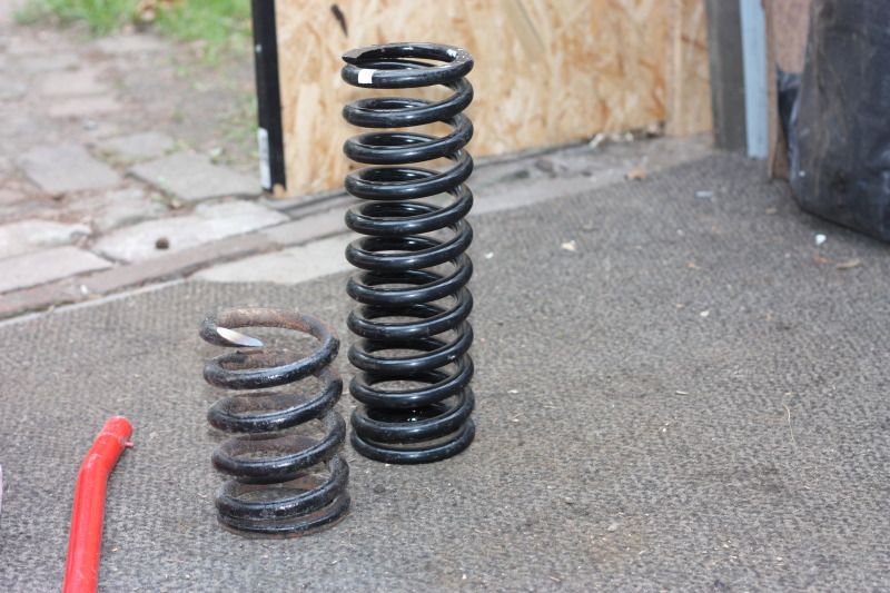

Another question is about the front springs:we've bought some lowered (1 inch)
springs and 'spax' absorbers (ride adjustable)but it still too high.
In Holland it is not allowed to cut the springs,so I need shorter springs.
Any options?

Our workshop/garage is very small, but big enough. its in our backyard. When the car is finished we need a crane to whip it out our backyard onto the street.

well your bonnet looks like it`s fitting pretty well, first get a striaght line on your bonnet all the way over from wing to wing, just use 36 grit sanding disc, that rub it back easy, then build your gap out from your bulkhead to meet your bonnet line, with body filler, thats how i got over the same problem as you."not much problem just few mintues of thinking...." HAPPY bulding

If you've seen my build thread then you'll see all the fun i had with the bonnet shut lines and even now i'm not 100% happy with how it turned out and i'm already planning on how i'm going to alter it all next winter (after a good summer of use!)
I don't think that there is any one way to do anything with these builds due to age and differences in donors and how we all want to tackle things, but knowing that i know now, i'd try and make up as much of your shut lines with fibreglass / jiggling before using any filler/bonding paste.

I can't help with the bonnet shut line problem as I haven't got that far myself yet, but If your regulations won't allow the springs to be cut you could try early Herald or Spitfire springs which are considerably softer. This should allow the weight of the engine to drop the suspension for you and give a softer ride than with the cut down springs we can get away with over here.

I am just going through the body alignment stage, and having the same challenges. I think the cost of the kit is very good, and perhaps a third of the price of most others, so you have to bear in mind that it also has some fitting issues. It will not fit right straight out of the box. It will need some work to get it to fit to your bulkhead/chassis/frame combination.
The advantage is that fibreglass is not a huge issue to modify and as Mulberry and DaveCymru have said, there are different ways of tackling the bonnet gap. Some build out the bulkhead and some add length to the bonnet. Either is fine and whatever works for you.
One thing to consider is some strengthening "webs" on the inside of the bonnet - Gary has added these to a car he was building and the big advantage with them is that is will help the bonnet keep the right shape, particularly down the sides where the catches are mounted.

Re springs I think you need much softer springs. If you just chop them you will have a hard ride. Fine for a smooth race track. The finished Sammio is much lighter, so you could nearly halve the rate to 100 lb and that would drop you loads. If you fit short springs there is a risk they will become unseated when you get airborne.
Going briskly on b roads is all about keeping the tyres on the tarmac, and hard suspension does not help that, even if it feels better! On the rear spring you could remove the top three leaves as well.

Here a shot of our project from yesterday (with the cut-of springs)
