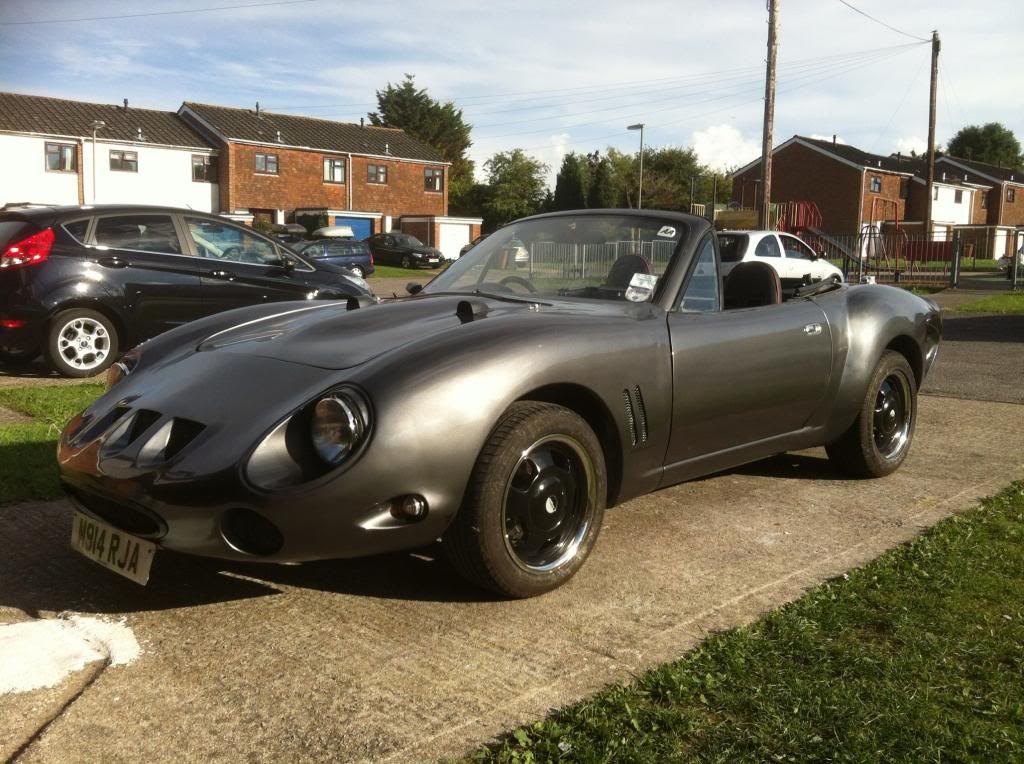

Jason (Drummajor) . Dorchester Grey

Posts: 748
I painted mine myself too, check out my thread on painting, I did it in a gazebo ? Really pleased to have done the whole car myself. When I build my next car I will paint it again myself . However my paint was expensive , I used Jaguar Dorchester Grey . Love it too

Posts: 748
